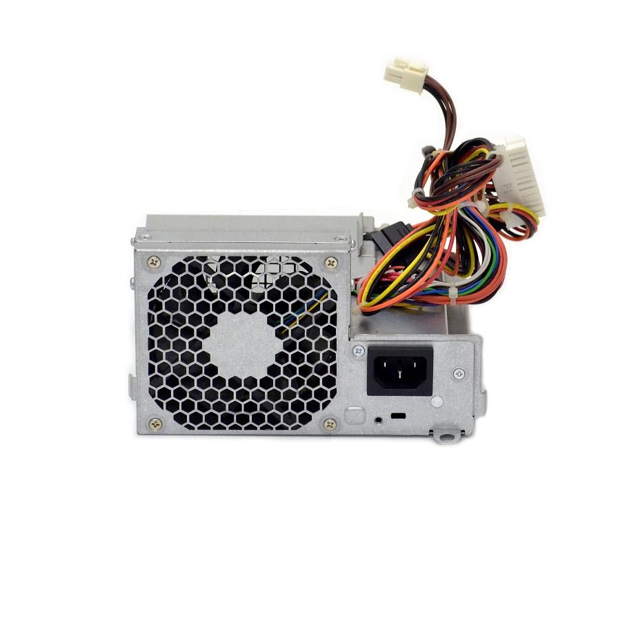

P.S. Judging by the PCI-E x16 slot this PC will only take a low profile single slot card video card (with a low profile single slot cooler). It should be able to take a dual slot low profile video card.
Found out the DC5800 uses a 92mm fan for the PSU.
According to the following document HP decided to deviate from the 80mm spec for CFX12v due to thermals and acoustics:
http://h10032.www1.hp.com/ctg/Manual/c02076124.pdf
the CFX12V standard power supply did not meet the product
quality and reliability goals for HP products. The CFX12V power dimensions
constrain the integrated fan to 80mm. HP found the 80mm fan failed to meet
thermal and acoustic performance requirements set for its business PC platforms, so
the power supply dimensions were increased to allow a 92mm fan. This action
effectively broke away from the ATX12V standard.
P.S. I would imagine if the thermals and acoustics are decent enough a person should be able to use some type of low profile video card in the last expansion bay. In order to help the hot air escape, the DC5800 should probably be positioned standing up:
(But maybe those vents adjacent to the first expansion bay are enough to even allow a horizontal orientation with a video card as well?)
