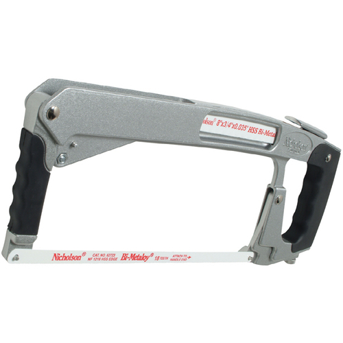

Myself, I use a shower curtain rod trimmer...
Available at finer home improvement and tool stores everywhere.
OOPS! Wrong Hacksaw...
