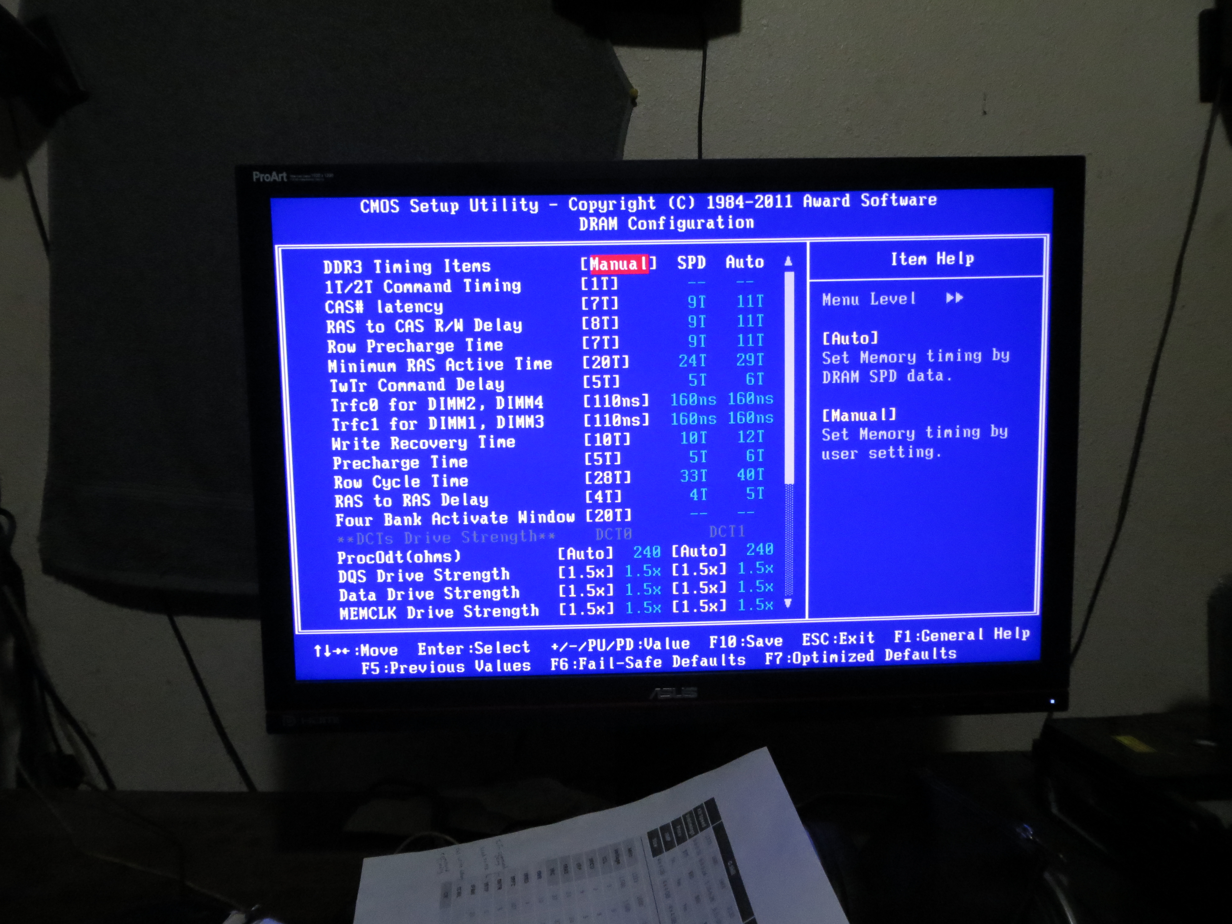

Currently, I've tried setting it to 1866 8,9,9,20 1T @1.5V and ran a memtest with no problems shown. And then there's these other timings that I just have no idea what to do with like the tRC, tWR, tRFC, tRRD. Am I fine with the above settings? And what do I do with the other timings?

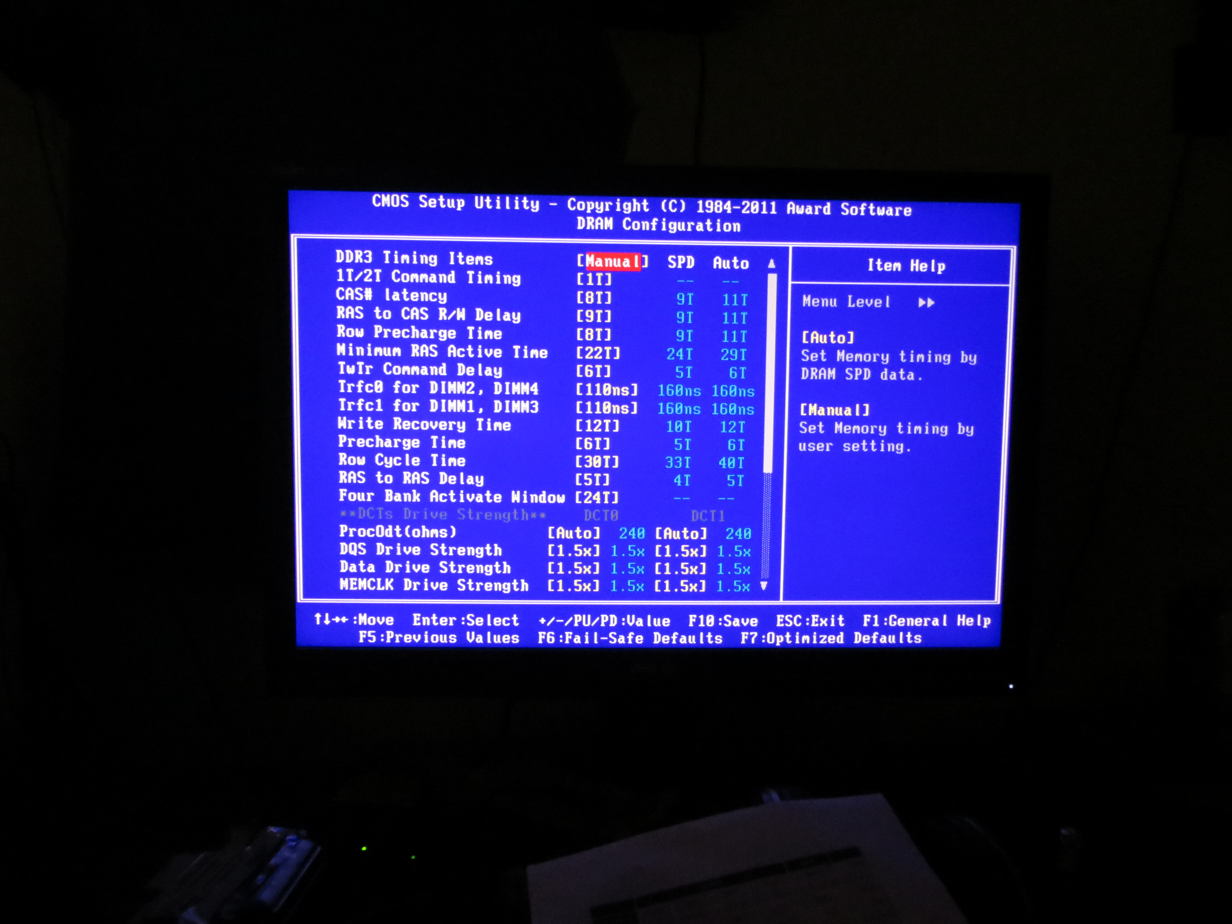

these are some relatively conservative timings I use for my 2133 set of mushkin on an fm1 platform at 1866 and 1.52v
I've had well over a month uptime with these timings more than once.
for me the set is rated at 10-11-10-28 so i'm essentially dropping them by 1
I'm running these timings at 1600 1.55v speed as I type this (very tight timings)
some more conservative 1600 timings that also passed memtest and benchmarks for me
your mileage may vary (not sure what chips your dominators have)
good luck
