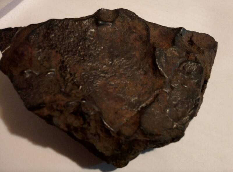

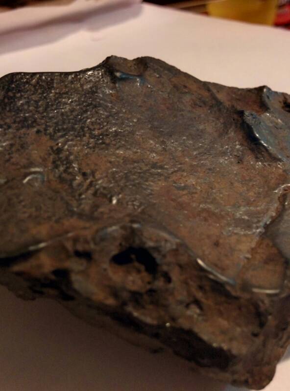

Found this bizarre rock? Metal blob? Thing earlier today.
It seems to be metallic and non magnetic.
Weight is not unusual for its size, it is a bit heavier than a rock of the same size.
4.5" by 3"
Maybe a pound or a bit less.
Pics

Wife said "bronzed poo"..but she's weird.
If it's a meteorite that'd be pretty cool! :)

Kinda looks like slag from a smelter.
Looks kind of like glass that gets made by something trains do(brakes?). Maybe they can do that to metallic stuff too. Where did you find it? Cool looking rock.

Smelter slag seems most likely, but the nonmagnetic part is strange.

Tap Slag?
http://www.brislingtonarchaeology.org.uk/museum/view.php?exhibit=110904a1
This dense slag comes from a bloomery furnace used for smelting iron from ore. As the temperature in the charcoal-fuelled furnace rose, the ore would begin to melt, but the first molten material that dribbled to the bottom of the furnace was not the iron itself. This hot liquid was vented – tapped off – in small rivulets and left to cool before being hacked away and discarded.

That sure looks like it, saw other pics of tap slag and some are nearly identical.

Slag.
But I am intrigued by "Looks kind of like glass that gets made by something trains do(brakes?)."

Interesting. Can you say where in general it was found? We can probably determine whether it is likely to be slag by looking at nearby industries, railroads, etc. I have done a lot of sleuthing out old forge and furnace sites in New Jersey and I have a pretty good sense of where to look for that kind of information.

You've never found obsidian on railroad beds? It might be something its hauling, but I assumed it was crap wedged into the wheels or something, heating up, then falling out. Dunno.

I was just teasing, I liked your phrasing. ;) The obsidian on railroad tracks is usually slag used as track ballast. Clinker (the welded ash from the bottom of the fire box) from the age of coal and steam is also fairly common. There are other cool things that trains make though. Train wheels sometimes peel (and peal) off thin layers of rail on the inside of curves. The thin strips get bunched up in front of a wheel and friction weld themselves together. On railways serving the iron ranges and steel mills or ports it is fairly common to find taconite balls.

Find it all the time along old lines, but as Ironwing pointed out it is glassy slag, not obsidian. You can also find a lot of coal along older lines where steamers ran, and firebox slag as well.

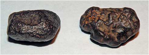

While walking along railroad tracks as a kid, I've found some stuff that looked like meteors. It looked like they hit the gravel HARD and broke apart.
With a friend, we brought them back. His dad said they weren't meteors and I never saw them again :(
