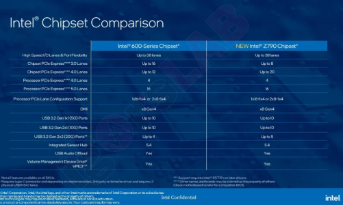

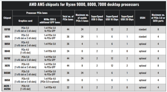

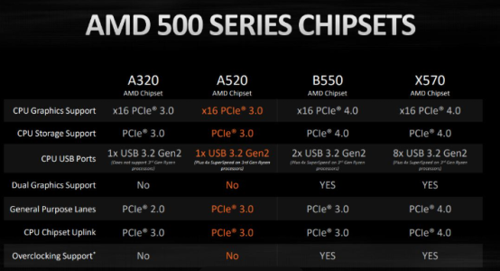

Source: AMD
AM5
AM4 (500 series only)
Intel 600 and 700 series
With the add-in cards you mentioned you can probably get away with any board that has 3 full size PCIe slots (4.0 is fine - 5.0 is overkill).
Without knowing what you'll be using this computer for I can't suggest a build.
Reactions: boed

With AMD from the CPU you get 16 lanes for GPU, than 2 x 4, typically used for SSD's. Anything else comes from the chipset. Some of those lanes can be used on extra SATA, USB, and ethernet though depending on the board. This video (timestamped, AM5 only) explains it very well.
Unfortantly a quick look at both AMD & Intel on Newegg shows that mobo manufacters love to use up those PCIe lanes on anything BUT PCIe slots. Even the ones that physically have the slots are given few actual lanes. They seem to think nobody uses anything more than a GPU and maybe one or two minor PCI devices these days and that is probably true.
Funnily enough, if you go back to AM4, you can find more lanes dedicated to the slots. Take this board for example. You get 2 PCIe slots (GPU plus one device) at PCIe 4 x8, but your other device would be limited to PCIe 3 x4. That was the best I could find. If you can live with something missing 4 lanes it would work. Otherwise you would have to go Threadripper it seems.
I did take a quick look at Intel too but it seems to much the same. However someone who knows Intel better may chime in.
