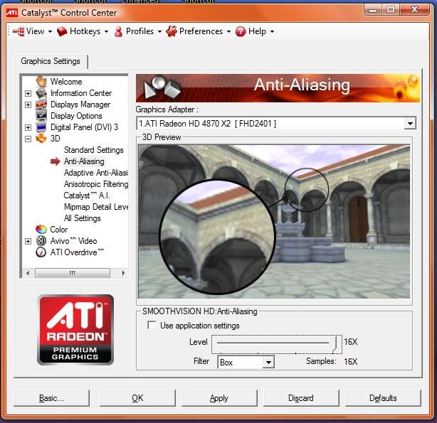

I am completely confused. Today i got an error with Catalyst, my screen froze, i reset the pc and when i logged into Windows i found out Catalyst driver was no longer working. I formated Windows and installed Catalyst again, everything worked normal, except that before i could set 16x anti-aliasing on CCC and now the max is 8x?

I am 100% sure that i could enable 16x Box AA. I remember it as clear as day that i would change it to 16x to play Prototype, using Catalyst 9.6. I was always able to do this, since i bought this card like a year ago.

The x16 box AA is actually their Super-AA setting, where each GPU is using x8 multi-sampling with different positions -- then combined to offer x16 multi-sampling.

I guess CrossFire isn't working then. I have formatted Windows and tried a bunch of different drivers and it is still the same, i don't know what to do anymore. Maybe my card has gone bad?

Download RivaTuner from Guru3D and use the hardware monitor. Open a game and see if both GPUs are running. If you don't have dual monitors it will do a log graph in the background, long enough to see if both of them are running right. If it's totaly screwed it may tell you without running a game.
