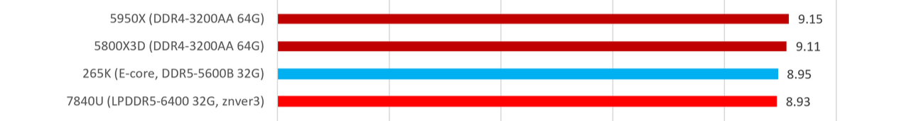

Based on that graph is Spec CPU 2017 clock normalized. I imagine it is.
So in that case Skymont IPC is roughly on par with Zen 3 or barely within margin of error 1% to 2.5% behind.
This is not normalized clock this is peak clock normalized this is clock normalized
Based on that chart it still looks almost on par wit Zen 3 overall, Though some workloads Skymont wins and some Zen 3 wins?
Am I missing anything?
They are clocked only 100MHz difference?
Oh wait Skymont 4600 5800X3D Zen 3 4500 and 5950X Zen 3 4900

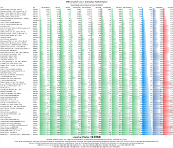

I wouldn't call Huang's tests particularly good, not the big one anyways. 13900K's P core gets 1.98, meaning it's just 6% faster than Zen 3, which is not the case. Golden Cove is actually if anything very slightly faster than Zen 4, which got 13% over Zen 3.
Also the desktop Skymont is only 13% higher than Lunarlake version, which is also too low.
I suspect he has difficulty really fully making it ISO-clock. Hence why I say compared to peak AT days modern reviewers, the best of them are second tier.
I am not sure I understand. The table shows the peak clock performance and PPC. The graph showed peak clock performance. Is this what you meant?
Andrei was using the same methodology. Measure at peak clock, then normalize back instead of measuring at fixed clock. Or do you mean other things?
Yes
Well tbh it's impossible to do fixed clock measuring on ARM platform cause they don't provide with the tools.
Whatever it is, discrepancies clearly exist in his tests, so he is missing something, and most of the time it's due to clocks.
-Turbo for example can deviate slightly from fixed clocks
-Tests have to be run 3 times, and SPEC takes long time to run
-A system with exactly the same settings, including OS versions(down to the build), updates, programs installed, we used to scrutinize over this. We know this matters, because one friend back in the day were submitting 3DMark results and he found ways to cheat to get accelerated results posted, and basically everyone in top 10 were doing it.
-This includes hardware of course. Same drive, motherboard and RAM settings. Of course you can't do it for all, but for desktops it's different.
-I would go over few well known sites when Sandy Bridge was introduced and noticed the reviews with SSDs got about a ~15% gain over the predecessor, and ones with HDDs got 12-13%.
Now if you assume it's a 1-man operation, and he has dozens of testing over widely varying platforms, it makes sense. When you are talking about few %, every detail matters.
