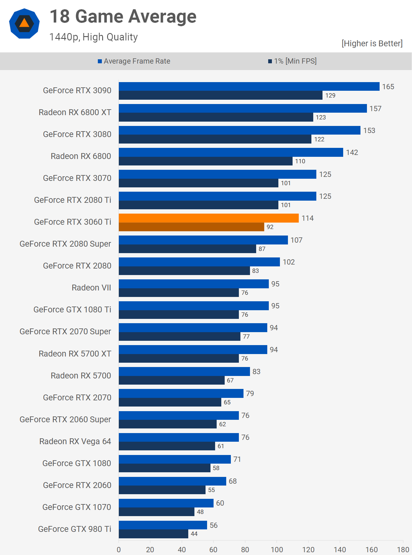

I dont know where you get your numbers but RX6800 has the bigger increase of performance over his RX5700XT between the three cards.
Unless you only care about the small list of current RT games, at the same price with the 3070 the RX6800 is simple the better product especially for 1080/1440p.
The first chart you posted has the min fps of the 6800 non-xt at 110.
the min fps of the 5700xt at 76.
76 / 110 = .69 = 69%
100% - 69% = 31% increase in performance according to your chart
I believe I said it was 28% increase. There is about a 3% difference between my numbers and yours. Factor in SAM, and it is going to be very close.

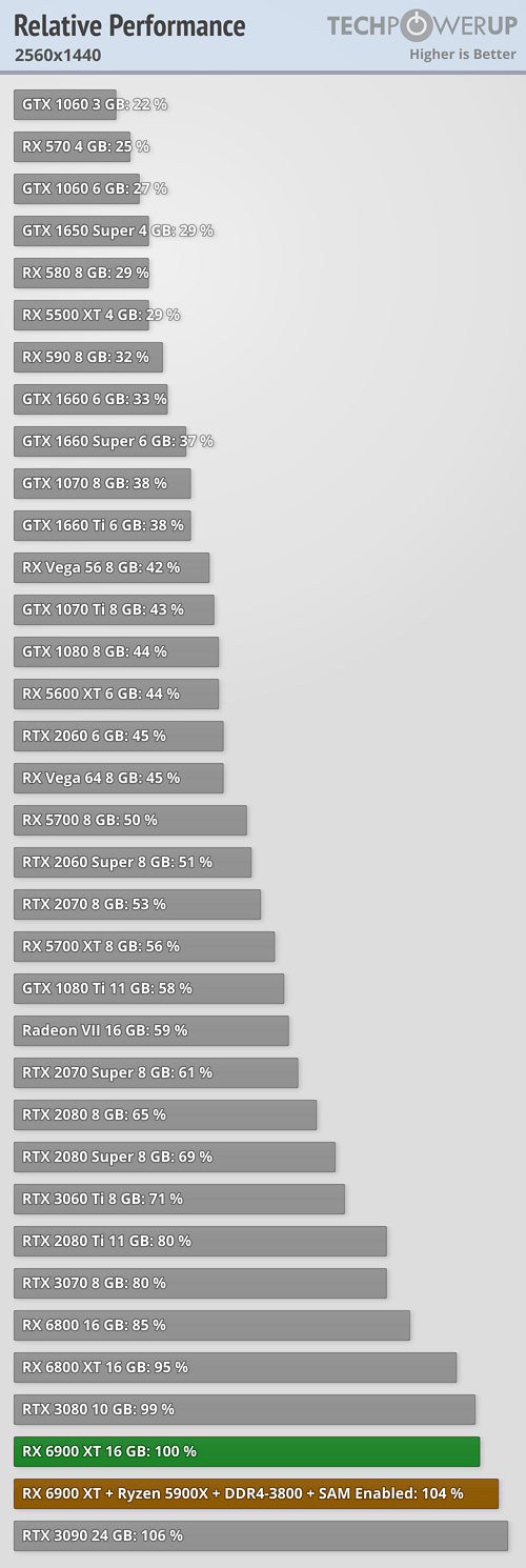

Both of the above reviews dont use SAM.
Techpowerup is using a Intel Core i9 9900K @ 5GHz and Techspot/Hardware Unboxed a AMD Ryzen 3950X
