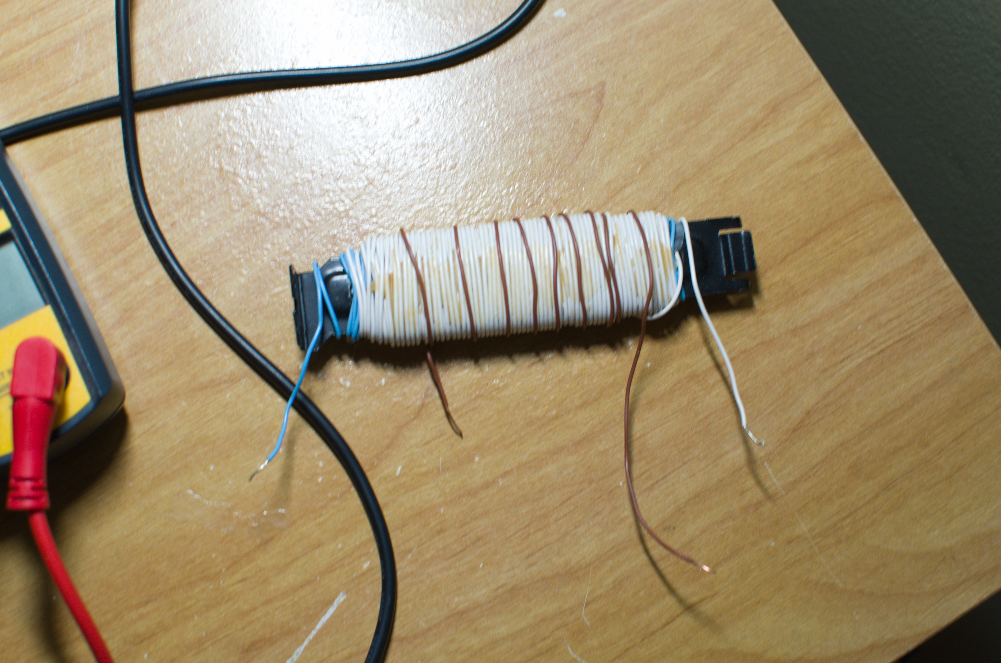

Hmm maybe I just don't have enough turns on the primary then (only like 10) since I tried and it did not work. Though, does it have to loop back around or can it just be a bar? Totally random experiment with zero purpose while I was bored:
Or could it just be that it's so inefficient my meter can't get a reading? Was using a ~30v AC adapter on the short coil.
Though I guess the other coil should be beside and not on top.
So basically the more metal that is around the coil increases efficiency as there's more mass to "store" the magnetism?
More metal? As in the core, or the wire itself? The core being metal has to do with permeability of the medium in which your generating a magnetic field. Iron has a high permeability and is cheap, so we use it to generate a stronger field and therefore a higher efficiency transformer. The wire just depends on the number of loops you make, and to a smaller degree the quality of the winding. Mass has little to do with it.

Meant the core. In my case it's just a flimsy little PCI slot spacer so maybe why it does not work, not enough metal to induce a decent field. If I put DC or AC current on the bigger coil it will act as an electromagnet though. A weak one mind you.

A transformer works by the process of mutual induction.
A time-varying current in a coil of wire will produce a time-varying magnetic field. That time-varying magnetic field will induce a voltage in a neighbouring coil of wire.
At the same time, the magnetic field will induce a voltage in the 1st coil of wire - this voltage will serve to oppose the supply voltage, and limit the current in the 1st (primary) coil.
If a current is drawn from the 2ndry coil, then it will produce a magnetic field which opposes the magnetic field generated by the 1ry coil. As a result, the voltage reflected into the primary is reduced, and the 1ry current can increase (as the supply voltage is less counteracted).
Quite how well this works depends on the inductance of the coils, and the degree of linkage (mutual inductance). This depends quite strongly on the strength of the magnetic field (or more precisely, the flux).
Magnetic flux, like electric current, can be thought of as flowing in a circuit (although there are no specific start/end pos/neg points, just a continuous loop). The same "magnetizing force" will produce a higher "magnetic flux" in a circuit with a higher magnetic permeability.
Iron has a very high magnetic permeability, so produces a high magnetic flux from a modest magnetomotive force. Air has a very low magnetic permeability, so any air in a "magnetic circuit" will greatly reduce the magnetic flux for the equivalent MMF (amps * turns). This property can be used to modify the properties of a transformer - for example, an arc welder may construct the iron core out of a "C" and an "I", the two parts are then mounted on an adjuster screw, so that they can be pulled apart or pushed together, allowing a small air-gap between them. The introduction of a tiny air-gap allows the overall magnetic permability of the core to be adjusted, changing the properties of the transformer (adding an air gap will result in have a current limiting effect).
If you try to make a transformer from just a rod, then it doesn't work very well, as the magnetic circuit has to complete the loop in air. The low permeability of air results in a small magnetic flux (relative to input current). Without a strong magnetic flux, you don't get good transfer of energy to the 2ndry coil when used as a "transformer".
A large air gap "transformer" can be useful, and is more usually called a flyback inductor. This used to be used for the generation of HV in CRT displays. However, it is widely used in cheap SMPS and as a HV pulse generator for vehicle spark ignition. In this setup, a DC current is applied to a coil on a low-permeability core. The current is allowed to ramp up (the inductance will slow the current ramp). As the current ramps, energy is stored in the core. The DC input is then shut off. The energy stored in the core's magnetic flux then has to go somewhere, and a voltage will be generated that will try to force the current through the coil in the same direction. This is "back EMF". This back EMF will be generated in ALL coils on the same core, and the pulse voltage is proportional to the number of turns. So, in a car ignition system, the primary side might have 100 turns, and the 2ndry 10,000 turns. When the ignition driver turns off, it might reflect 250 V back into the primary side, but because of the turns ration, the 2ndry will have 25 kV reflected into it.
The opposite turns ratio might be used for a phone charger - in order to assist with step down. By having electronics monitor the voltage reflected back into the primary, it is possible to determine the voltage on the 2ndry side (and therefore regulate the output voltage with feedback to the SMPS controller) without needing to electrically connect the input and output (for safety reasons).
What were the other properties of the 30VAC power supply? With only 10 windings if it were not current limited at 30V it would probably melt the wire. If it is current limited then the voltage may be dropping very low or the PSU shuts down, or blows a fuse or other component.
Yeah, you probably had problems registering a current with your Voltmeter (your typical Voltmeters need at least a small current for themselves to measure).
You need to keep in mind with your little experiment that:
U*I(primary) = U*I(secondary) (minus transformation losses)
...should result in a high voltage and a very small current with the number of primary and secondary loops you've chosen. Add that most power supplies can not sustain their rated output when you (almost) short them.

Oh that does make sense, could very well be what is happening in my case I'm just completely killing the source power supply when I put it in a dead short like that. The big coil is about 1 ohm even that is practically a dead short depending on how much voltage I give it. (ex: I would not plug that into the mains, or it will go poof) When I put it on the other side the voltage of the small coil is probably simply too small to detect with the multimeter.
Of course in a real transformer I'd be using much thinner magnet wire too, the coils being tighter (less insulation thickness between wires) probably adds to the efficiency as well.
I may experiment further, it seems I'm on the right track. Would be a fun project to build a super high voltage transformer from scratch to build a tesla coil or something. Sure you can buy one, but more fun to build yourself. :biggrin:

The problem you've got is that current isn't being adequately limited in your coil.
It is the magnetic field in the core being reflected back into the primary that limits the current. If your magnetic flux is weak (because you have an air gap in the core) then very little gets reflected back and you get no significant current limit effect - the coil acts like a short circuit. (but see below)
You could make it work with a ton of turns, but a proper core would make a big difference.
Technically, any inductance has a current limiting effect when used with AC. However, there are limits. Inductance actually limits the rate of change of current (it makes rate of change of current proportional to voltage). In an AC circuit, when voltage is constantly changing and reversing, then this effect is to limit the current. Note that the "impedance" of an inductor with AC current is proportional to both inductance and frequency.
If you use a higher frequency, you can use fewer turns and a smaller core - which is how a SMPS is able to push 1000W through a matchbox size transformer, whereas a 60 Hz 1000W transformer is as big as a house brick and weights about 15 pounds.
If you use a ridiculously high frequency (100s of kHz, or MHz) then you can use a low-permeability air-core - and this is how a Tesla coil works. You needs such a low inductance, that an air core will work. (There is also the issue that you can't use iron or ferrite at these frequencies, because they magnetize too slowly).
I would abandon trying to make this work with a piece of iron, and find a scrap transformer; rip the windings off and then have a go winding your own on top of that.
