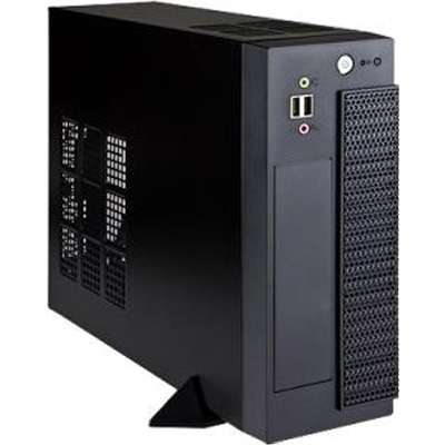

In Win BP655 mini ITX case with Haswell Ready 200W power supply, 8cm Fan, Black, TAC 2.0, Front USB 2.0X2, HD audio, $49.99 free shipping:
http://www.newegg.com/Product/Product.aspx?Item=N82E16811108196
11-108-196-Z01
11-108-196-Z05
The following Inwin Models have the same chassis as the one above:
In Win BP671 mini ITX case with Haswell Ready 200W power supply, 8cm Fan, Black, TAC 2.0, Front USB 2.0X2, HD audio, $58.47 free shipping:
http://www.newegg.com/Product/Product.aspx?Item=9SIA2F84D68873
IN WIN BP691.FH200B Black S.F.F Slim Chassis (Ultra Small Form Factor) Computer Case Standard TFX 12V, 200W Power Supply, $59.07 free shipping:
http://www.newegg.com/Product/Product.aspx?Item=9SIA2F84H09137
P.S. Here is a video showing a build-up. (Notice this case has much more room for the CPU cooler compared to APEX MI-008/Rosewill RS-MI-01 due the PSU being next to the motherboard rather than right above it, but notice it cannot fit a full height single slot card. Only a low profile single slot video card will work here.)
