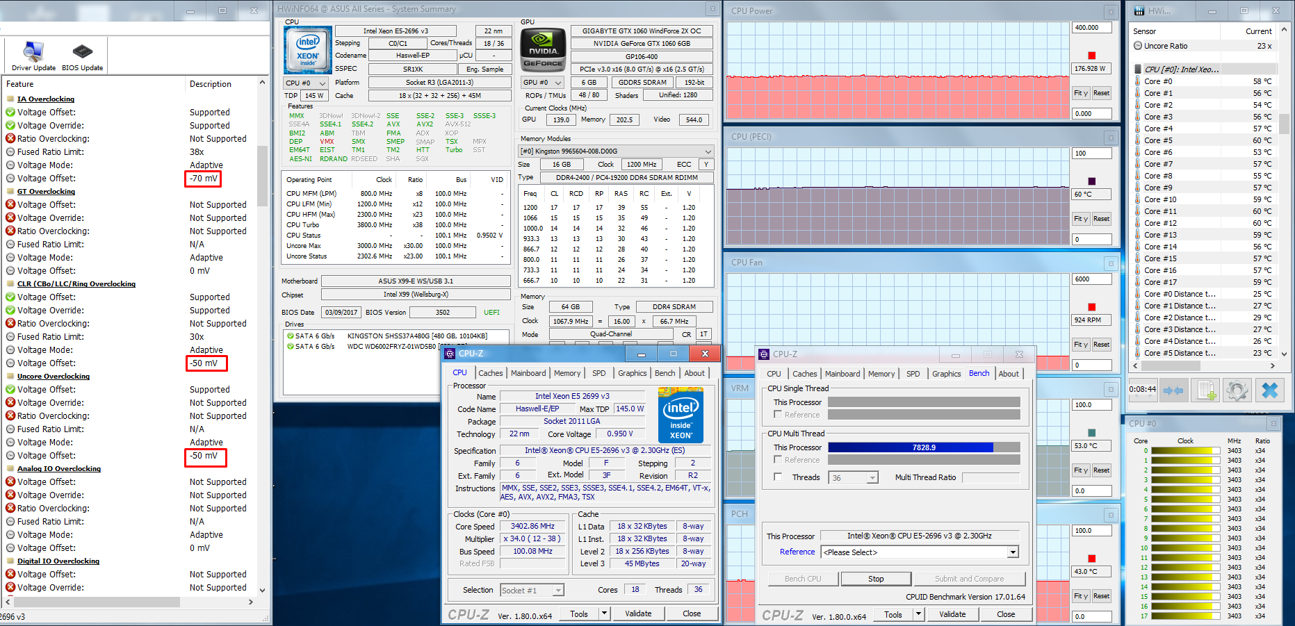

I have Asus Z10PE-D16 WS, and recently upgraded my pair of E5-2666v3 -> E5-2696v3.
I'm noticing a few interesting things: many of the EFI drivers here that do a -50mV don't work... I assume it's just too low voltage for the chip. (I might be able to adjust it in the bios a little higher to overcome that, haven't tried) The only EFI driver anyone has posted that works without issue is v3x2_payne_20_20.efi.
So, my results have been interesting. In particular, with high core counts, the multiplier never goes above a certain point, even if only a few cores are loaded. So, I tried setting to use lower cores in the BIOS, and that definitely helped.
10 cores: 37x on both CPUs
12 cores: 34x and 35x
14 cores: 33x and 34x
16 cores: 32x and 33x
18 cores: 31x and 32x
18 cores is interesting though... it seems to have trouble keeping power up (or thermals maybe? doesn't seem to go much above 70C ever?) and periodically drops from 3000 to 1200 for a few moments on some of the cores, then goes back up and down like a seesaw. The end result is that Cinebench, CPU-Z, Intel Burn test, etc, all do *terribly* by comparison to only having 16 cores enabled, which works amazingly.
I plan to evaluate a better cooling solution soon anyway (Hyper 212 evos right now), but assuming the issue is power related, any thoughts on BIOS settings I can try tweaking, etc? Even in a worst case, the 16 core performance is quite great, and I can switch down to 10 or 12 if I really want higher clocks and am not doing heavily parallel workloads.

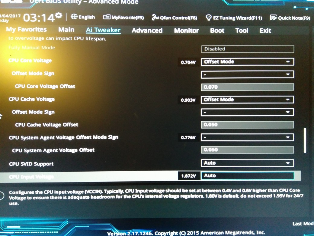

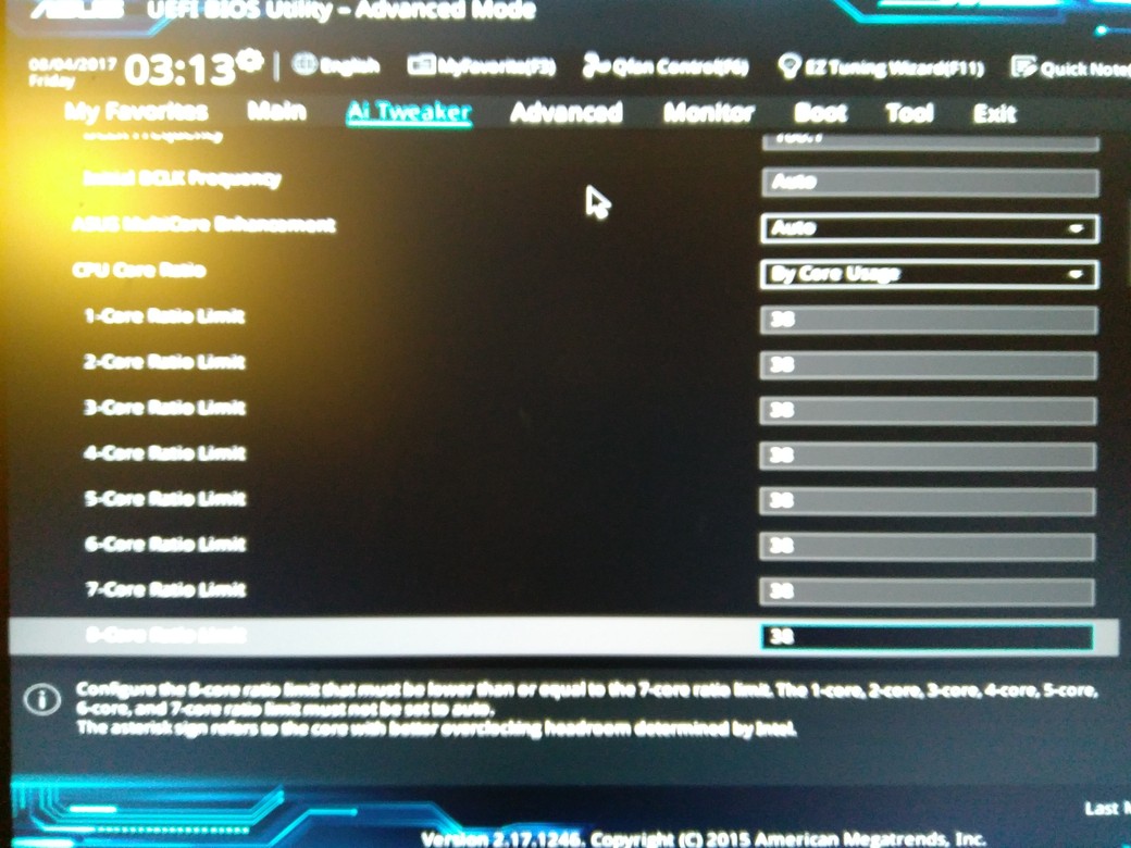

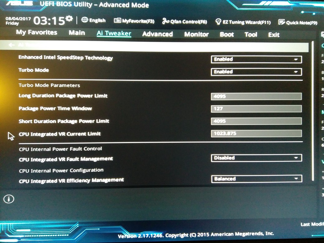

My E5-2696v3 QS works at x34 perfectly fine with these settings (no efi driver), you can try them:
Thank you so much! It will be very useful for many people. A doubt? Is it necessary to remove the microcode from the system32 folder (mcupdate_genuineintel.dll)? I am not getting permission to del / rename as in win10 1607. I am using Win10 1703 Creators.
