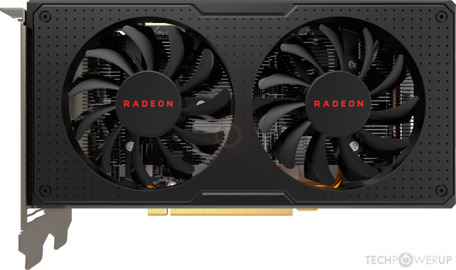

Yeah, I would probably go with an RX 480/580 8GB. A 1060 6 GB or 1070 might also be a decent idea. I might be wary of 6600 cards, due to being more prone to bottleneck of the 4770S in general, but also because they will be limited to PCIe gen 3 x8 on your system, which may also contribute to the bottleneck.
Don't forget about the rx590! A update on its better known cousins the rx480 and 580, and far less well known. More likely to go cheap on ebay as result.
rx590 released in December 2018
rx580 released in April 2017
rx480 released in June 2016
An rx590 will have about 2.5 less years in the mines then a rx480. Also has about 10% more performance then a rx580, and 20% more performance then the rx480.
AMD has already stop issuing new game optimizations on the rx300 series, and the rx400 series will be next. But the rx500 series sold very well, and I feel it will be a long time before those get the axe.
I don't think there is that much difference between a 480/580/590, probably a lot less, of course it will vary by clocks and PCB/cooler design a bit. Also, RX 400 and 500 series are pretty much the same thing hardware wise, so they will likely go DOA at the same point IMO. Now AMD could do differently, but it wouldn't make sense, they are all Polaris.
I would disagree. People with cards a few days old were getting fried left and right. It was not just EVGA, and it was not just the inadequate backside cooling ( or complete lack thereof ). Something in the power supply for the memory was not right.
As for the 3090 frying issue, this was not a double sided memory issue AFAIK. I thought it was more of a QA issue, but I suppose it could be argued it was a design flaw, with using the POScaps and drivers allowing boosting too high. Still, it wasn't design defect due to double sided memory that caused this.
I will say the 590 could also be a decent option, the only caution here is I feel those might not actually last as long as the 580 cards, due to being the same hardware but pushed further. Or was there an actual hardware resfresh/die shrink with these, or did they just have higher clocks and beefier coolers? I cannot remember exactly. Anyway, use good judgement based on what you find available and what the price is.
Lastly, if you want to go a bit higher, the Vega 56/64 could do well (instead of a 1070 or 1080), as long as you are getting one with a good cooler. These cards of some brands had really bad cooling designs, mostly for reference and some coolers such as with Gigabtyte cards, but the Sapphire Nitro and Powercolor Red Dragon designs were excellent.
Very unlikely, as Shmee said they are both Polaris. Both are GCN4. Considering that previous GPU's were 28nm vs 14nm, Polaris could perform similarly to the 390(X) while using 100+ less watts. There is no need to cut them off just yet. They will almost certainly be removed at the same time. I wouldn't recommend a 590X as it really pushed power to get relatively little gains.
rx590 vs rx580 - 10%:
rx590 vs rx480 - 20%:
That is pretty significant to me.
No! That is wrong!
rx590 uses 10 less watts then the rx580:
What you both missed is the rx590 is a redesign of the rx580, moving it from 14nm GF to 12nm TSMC. The 590 is just a better chip, uses less power, runs cooler, and clocks higher. The rx590 was AMDs first TSMC GPU! AMDs first high end TSMC product!
This was the tipping point, after the rx590 AMD would slowly move everything to TSMC. The rx590 is not only important historically, it is also the best rx500 series product!
No! That is wrong!
I didn't miss a thing. The Rx 590 has a 40W higher TDp at 225W vs 185W of the 580. it was also 12nm GloFo, not TSMC. Remember when Anandtech used to review GPU's?
"From the wall, the RX 590 now pulls 30 to 45W more than the RX 580 in Battlefield 1. The difference in FurMark is even starker, with the RX 590 now drawing 45 to 80W more ". I'm not saying it's a bad card but Notebookcheck got it wrong.

Your toms hardware link discusses it a bit, it finally concludes:
As such, we're probably seeing GlobalFoundries' 12nm LP process
They made a compelling argument off the chip size, but do not claim to actually know.
Your tech power up link is interesting, as it claims:
This chip comes in both Samsung 11nm and GlobalFoundries 12nm.
in the notes (scroll down a bit). Which I found fascinating.
I should clarify I wasn't 100% sure it was GloFo 12nm, just pretty confident. IIRC 12nm TSMC is more like 16nm+ and I wasn't sure if it was even available when the RX 590 came out. I searched and saw the same Tomshardware review so I felt pretty safe in saying is was 12nm Glofo. The Samsung bit of info is interesting though.
The 590 was in a tough spot though. Vega 56 was considerably faster and used the same power for the most part. The problem was getting your hands on Vega was usually a tough task at any reasonable price. If Vega had been more plentiful we may have never seen the RX 590. On a somewhat related note, it's amazing how much more power the Vega 64 used. In bench it uses 80 or so watts more than the 56! Talk about being pushed to the limit.
