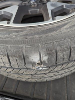

Went to go get donuts and on the way back the tire pressure light came on and the car didn't feel quite right.
Hmm...wonder what the problem could be
AWD so I guess I'm getting 4 new tires

How big is it? Scale is hard to tell. I'd do 5mm, no problem. Over that, I'd make a judgment call. If high speed isn't immediately necessary, you could set a plug and see how it goes. I've plugged some fairly big holes, and never had a problem when being reasonable. My only failure was a hole I put 6 plugs in. I hit a piece of rebar or something, but it got me off the side of the road, and back to the office.

So, you got one of those in each of four tires?
Generally on AWD vehicles if you replace one tire you need to change them all as the larger diameter on the new tire (due to less wear ofc) can play havoc with your drivetrain and traction control etc.
That said looks like there is quite a bit of tread on these tires, might be able to get away with replacing just one.
Better to plug it though.
@Exterous what even is that though? Looks like you drove over a pencil or something, but I feel like that shouldnt be able to do that kind of damage to your tire.

Looks like a driver bit. I've found numerous in the road, but none in my tires so far.
edit:
If it is a driver bit, I'd absolutely plug it.

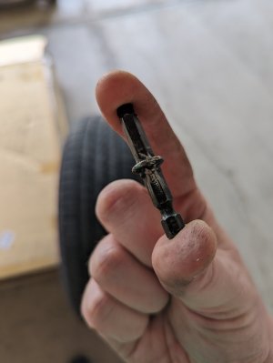

We were about 70min from home avoiding highways on the spare. Anyway here's the culprit
1/4 but but with the flange its 1/2 and the flange stretched out the puncture (the tire was gripping the flange itself when it was embedded)

I'd still plug it. Get tires in the fall to prepare for winter. It's like getting a few free months out of them.

Idk ... if you don't drive on the highway or aggressively maybe but that puncture is right where the bead meets the sidewall. The strength of that tire has been compromised.
I mean if you want to get crazy you can always patch it and throw in a tube! ;)
*(but I still suggest 4 brand new tires!)

That tire's fine. I've driven fully loaded small trucks on worse. As long as he isn't trying to peel the rubber off the wheels when he leaves lights or something, a plug will last til the cords are showing.
