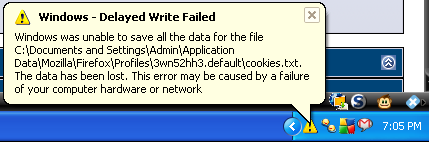

I knew I should of asked earlier, but now I'm paying the price. The drive is only 5 months old.
http://i73.photobucket.com/alb...dWriteFailed9-9-08.png
I got 7 of these in 7 minutes, I saved 3 other screens, but they all got corrupted and this is the sole survivor.
Not just Firefox, but writing to .png as well.
Leading up to this my computer would freeze up every few minutes for a few seconds.
Since maybe 3 months ago I started having 90% of the desktop icons go white/blank occasionally.
It's picked up in the last week, the stuttering and etc, but now I'm having write errors. Everything I do on the computer takes a few seconds to go though, even simple things as writing text it will stop for a few seconds.

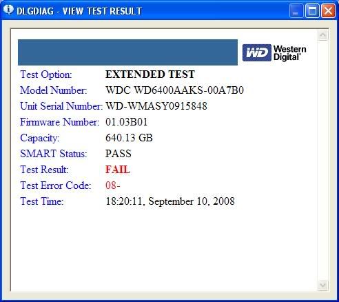

http://i38.tinypic.com/23msn7s.png
That's what started acting up before the pauses, before the error messages.
Anyway, I got my important stuff off and I wanted to try to image it anyway.
So again I'm gonna ask for suggestions to TRY and copy my drive over to a new WD6400AAKS, thanks.

my guess is corrupt OS files.. the clone copied over corrupt files....
do a clean reformat
