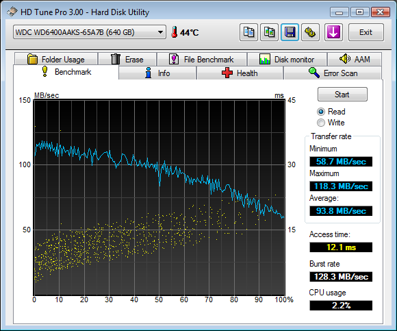

Your latency is very high, mine scores 11ms.
Try adjusting the acoustic management on the drive using hitachi's drive tools.

What motherboard are you running? I just replaced 2 150GB raptors in raid 0 with 2 6400AAKS's in raid 0 and I am more than impressed! In Matrix raid 0 I'm getting around 11ms seek time and 196MB avg read. They really do load games a bit quicker than the raptors I had. I wish I could justify getting a couple of velociraptors :)

If write back caching is "Enable write caching on the disk" then yes, I do have it checked. I'll look into that acoustic management thing.
I'm using a Gigabyte P35-DS3L mobo.

Try defragmenting the drive, and enable "advanced performance" if you are on vista. I just got the drive a couple days ago, and before defraging it was really slow, well it booted slowly, but after a nice and long defrag its really responsive.

Actually those numbers are in line with my new WD6400AAKS. I have 2 of them and the first one I bought is 12ms while this second one is 15-16 ms. I just got the other drive formatted and tested just as I did with the first.
I thought it was something on my end but now that I see this thread it makes me wonder if WD changed something.

So the Hitachi acoustic management tool works on WD drives? To turn it off I mean since WD doesn't have one.

Yes it works. The thing is though, my drive came with acoustic management set for lowest performance. If you just turn it off, the drive will stay at that setting. So instead of just turning it off, set the drive for highest performance, then turn it off.
Access times went from 16ms, to 11ms when I made that change.

Are there any negative effects of changing the acoustic management to a different setting? Does it put more wear on the drive? I mean, if it increases performance with no negative side effects, why isn't the factory default set for high performance?
