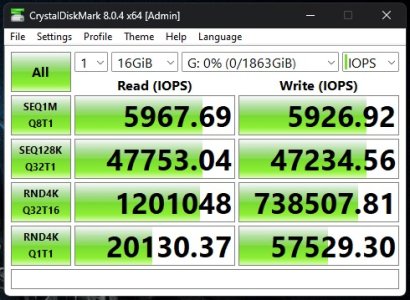

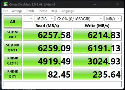

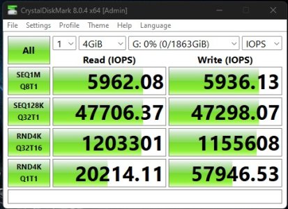

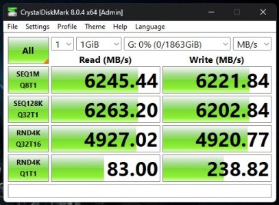

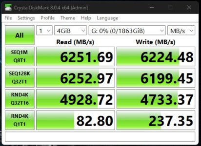

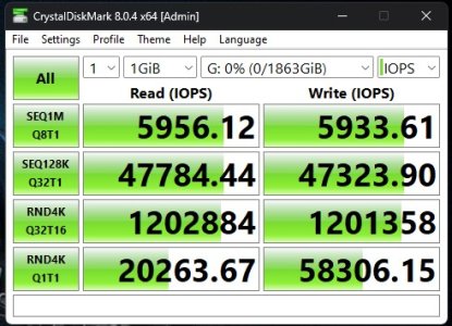

I just got a 2TB WD SN850x. It is installed on the second M.2 slot on the motherboard (the first slot has a 1TB WD SN850). I am seeing lower than expected speeds on CrystalDiskMark.
1 GB
4 GB
16 GB
All the numbers seems to have hit a cap - sequential read/write (SEQ1M) floats ~6200 MB/s. Bottleneck somewhere ?

Well, just came across this thread:
<< LINK >>
Boards like the X570 Hero Crosshair VIII have the 2nd M2 slot connected to the chipset. Although this slot is supposedly X4 Gen4 Pcie it bottlenecks new, fast SSDs like the 980 Pro and sn850. In the primary M2 slot you may get 7000/5000 MB sec read/write but in the 2nd M2 you may get 6500/3200, way below the x4 Gen4 pcie spec.
Asus support confirmed in my support case that there may be significant latency induced when using the 2nd M2 due to the chipset and this causes lower speed. I was surprised to hear this.
I guess that answers my query ? 🙄

It's not an issue with the SN850X. It's precisely the thread the OP found - Only the top/primary M.2 slot is direct CPU connected PCI-e lanes.
All the chipset-derived lanes will be limited in absolute throughput exactly as demonstrated. I have personally tested this on 2x X570, B650E, and X670E boards. I have also assisted several people with various other AMD boards with chipset-derived lanes.
Overall real world performance should not see a significant hit, not nearly as bad as the CrystalDiskMark makes it look. However, I understand the disappointment through my own experience using chipset M.2 slots.
