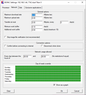

@Markfw, besides temporarily suspending the WCG tasks which are stuck in downloading state like @mmonnin03 suggested, try if an increased "Minimum work buffer" and decreased "Additional work buffer" keep your workqueue better filled.
Besides, make sure that cc_config.xml's <max_file_xfers> is always larger than <max_file_xfers_per_project>. Also, I wouldn't set <max_file_xfers_per_project> too high if dealing with weak project servers. BOINC defaults are <max_file_xfers>8</max_file_xfers> and <max_file_xfers_per_project>2</max_file_xfers_per_project> which should be good in most situations.
