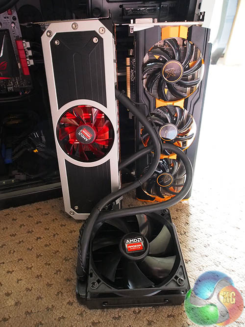

I don't think so. If you look at the metal I/O bracket, about 2 of those are the size of the entire PCB. It looks like the card is now 2/3 of the size of an R9 295X2.
I mean it looks significantly smaller in size compared to modern cards.
It's much bigger than Gigabyte's or Galaxy MiniITX 970s:
The size seems closer to the Zotac GTX970, but with a slightly longer PCB where as the Zotac 970's heatsink extends beyond the PCB.
2/3 of R9 295X2 (12.13") => 8.09". I think sub-9 inches seems possible for Fiji XT. Maybe 8.5"?
What does that mean? A flagship card with nearly 300W TDP in what looks like an 8-9" PCB with warrantied AIO CLC that will make it cool and quiet is disappointing to you? We just need performance and price at this point. The design part they absolutely nailed. What did you expect? Another reference blower ~11" card that sounds like a jet engine?
Blowers for flagship cards are not the answer either. Titan Black 250W TDP = 57 dBA at 3100rpm to maintain the same temperatures as an after-market cooler can do at 46-48 dBA at sub-2100 rpm.
If PC gamers embrace AIO CLC for flagship 250W cards, it's going to be possible to make cool and quiet 300W flagships for both AMD and NV, and thus create a CF/SLI setup with most of the heat being exhausted out of the case. For gamers who still want air cooling, there will be open air cooled after-market versions. The blower has really shown to be ineffective for flagship cards like he Titan X once overclocking comes into play. It's not really acceptable to put such a crappy heatsink on premium products anymore as gamers demand superior cooling at high price points.

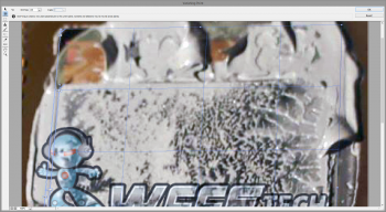

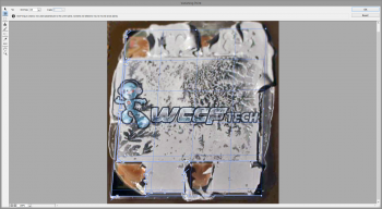

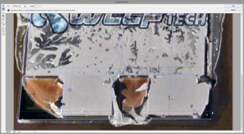

We do know the size of the HBM chips from this slide:
Let's do some measurements on photoshop with vanishing point. I've measured stuff this way and so far this method hasn't failed me too much, all you need is a good reference point. I took the interposer as the plane, then set the length of one of the HBM chips as a reference point, 7mm. From that, I started measuring the rest.
We know the other side of the HBM chip is 5mm, and the 5.02/5.03mm measurements on both sides of the HBM chip seem to be on spot on where the thermal paste lets us see where the chip looks like it ends. Good, this means we can somewhat trust what's on the picture with the official info in the slides. Now we measure the rest:
GPU: 23.12*25.66mm = 593.25mm².
Interposer: 36.9*27.09mm = 999.62mm²
Taking some margin of error into account, the interposer number is strangely a round one... and the GPU looks to be nearly 600mm²... interestingly near the same size GM200 is. Isn't about 600mm² the supposed limit of what TSMC can manufacture? I don't know where I read that but it rings a bell now.
Just imagine for a second an AMD GPU that is the same size as one of nV's. Throughout those years we've seen RV770/GT200, Cypress/Cayman-GF100/110, Tahiti/GK104, Hawaii/GK110. AMD's GPUs all these rounds got dangerously close to beating or beat nV's best while being quite smaller chips! We've all at some point given a bit of thought to the idea of what would happen if AMD decided to go right up to nV on die size.
If these measurements are anything to go by, Fiji should at the very least make nV uncomfortable. Release it already, AMD!

Using vanishing point you only need one correct measure and the plane you've selected. It bases everything off that. If you're accurate enough on selecting these two starting points, you can more or less trust what the program comes up with. I've taken pictures of things at awkward angles like the one we have here, measured this way, then measured the objects themselves with a ruler and the results were more than usable.
The length of the HBM chip and the GPU are thankfully clearly visible in the picture, they have no paste at all. If we believe that slide and use 7mm as our known measurement, that alone is enough for estimating the rest. If we round my measurements:
GPU: 23*25mm = 575mm².
Interposer: 37*27mm = 999mm²
Completely plausible I think. Of course we now have a discrepancy, AMD claims 35mm² (5*7mm) in their slide for a HBM chip, Hynix 42mm² yet they don't give measurements on how they got to that figure in their presentation... We can at least be sure the GPU is over 500mm². It had to be considering the rumored specs (4096sp, etc)
