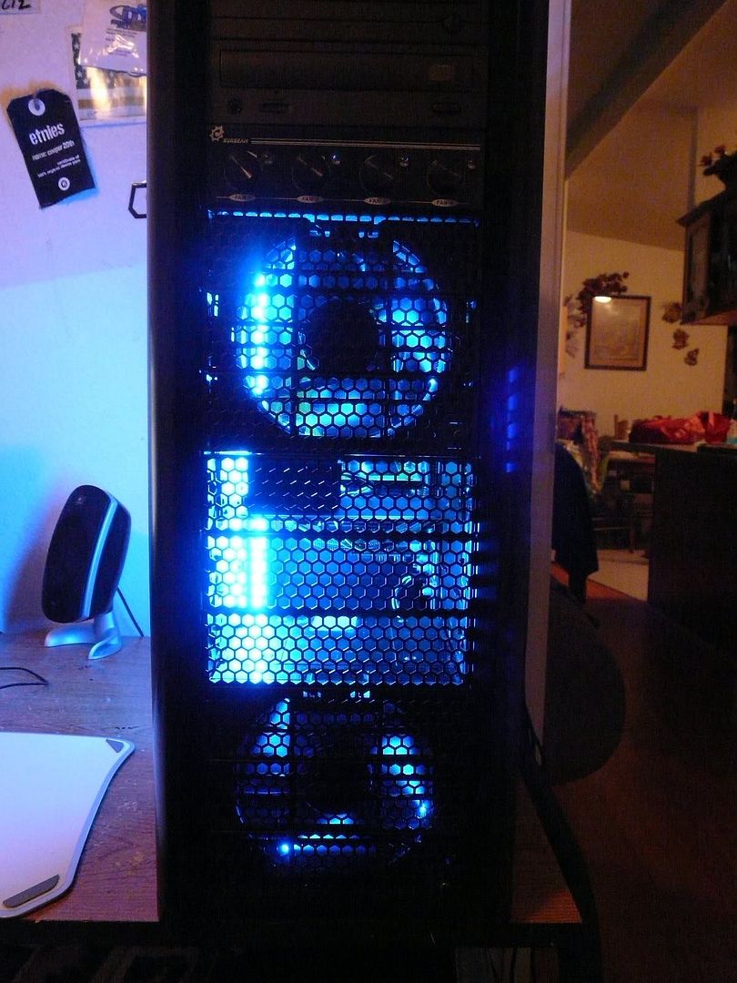

GPU idles around 36ºC right now at 78ºF room temp. Used to idle around 61-64ºC and go to ~80ºC or less while gaming
Vid card OCd to 720/1480/1220(2440 mhz)
I ran out of hose but when I get more, I'm gonna move the water pump further down to get that long hose out the way running straight across the GPU from the radiator. I removed 2 of the 3bay HDD cages to make space for the plate that the pump is sitting on for now and had to remove a front fan as it would all fit right, I am gonna replace the fan once I get more line and move the pump down. I have also concluded that the Antec 1200 is almost too small :laugh: I sure coulda used another 3-4" of length and more room between the GPU and rails holding the 5.25 bays
I am very satisfied right now with the setup and have no complaints :D :D :D
a Guiness :beer: would set this off real well :thumbsup:

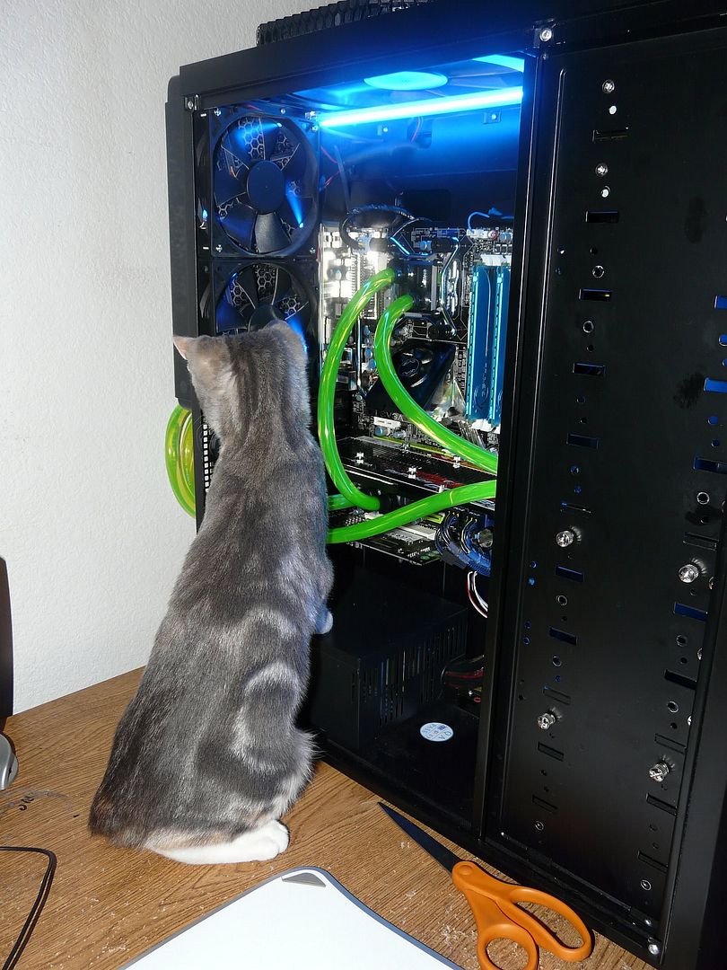

Bit of humor :laugh: :laugh:
http://i70.photobucket.com/alb...atercooling/WC2008.jpg
http://i70.photobucket.com/alb...atercooling/WC2009.jpg
Best :thumbsup:
http://i70.photobucket.com/alb...ercooling/WC2007-1.jpg
NEWST UPDATE
Got me some Vinyl tubing at home depot, 10ft for 4.15$
http://i70.photobucket.com/alb...ercooling/WC2009-1.jpg
http://i70.photobucket.com/alb...ercooling/WC2010-1.jpg
http://i70.photobucket.com/alb...ercooling/WC2011-1.jpg
