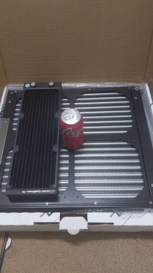

Water cooled Titan V rig
I've got this one too, but with nine 120mm fans instead of four 180mm fans. It's on a system with three 1080Ti and formerly a Broadwell-E, later Broadwell-EP. Some might remember this anecdote of mine: During a SETI Wow! Event, the plug which powered those nine fans accidentally detached. I didn't notice this at first, because the rig continued to run even without noticeable reduction of GPU clocks. And that was even though it was still as warm as typical for August in Germany.
You have the 360 version. The one I posted is the 420 version and will have four 200mm fans.
Thats impressive that the system still ran really good in hot August passively though!
Nice one! The 420 is definitely powerful. Which version of the NF-A20 do you want to use? I have the HS (high speed) variant of the NF-A20 on all my 420's (more headroom, 1.200rpm instead of 800rpm).
