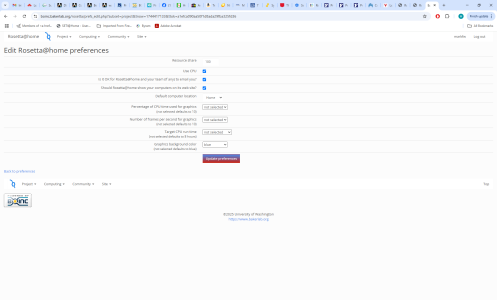

Because Rosetta has no app selection.
I guess one could write an app_info.xml which includes only vanilla Rosetta. But this wouldn't repair the two unstable computers. Besides, if the affected computers received both vanilla and beta tasks, we don't actually know which of the two crashed the computers.
