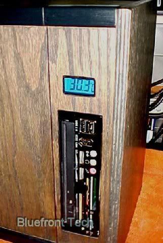

Google for "Scythe Kama Panel"........It's a 5.25" bay device that holds a laptop optical drive, as well as a card reader, fan controller, a bunch of ports, etc. It comes with a big box of cables, as well as the adapter for the optical drive (they're not all the same however).
I bought two black units from NewEgg a few months ago....about $35 ea.
Here's one mounted vertical in a SFF I made. It uses a slot DVD..... Link.
