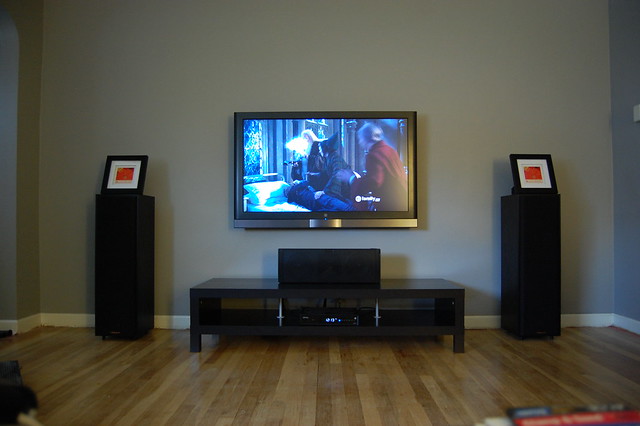

this is from when i first mounted it back then.
http://i.imgur.com/jUDSz.jpg

The one I bought:
http://www.monoprice.com/Product?c_id=108&cp_id=10828&cs_id=1082807&p_id=4114&seq=1&format=2
Pics:
The 47" when it was 1st installed
In wall wiring:
60" Vizio
