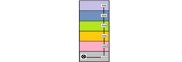

Like this?

Like this?

Also, that topology diagram you posted is a terrible idea from an availability perspective; it makes every switch a single point of failure for all the floors above it.
