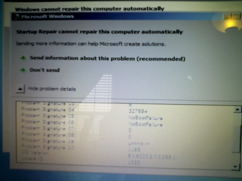

Okay, well, easy enough. I popped in a Vista Ultimate DVD that I borrowed from a friend (I don't have the Home Premium DVD). I went to "repair installation" to repair the Vista MBR, and it work. I also tried doing it manually in the command prompt. Then, I tried to boot into Vista, but it kept restarting without even displaying the "Windows" screen. Going back into the Vista DVD, I tried the complete "repair installation" on my Vista install, but here's the screenshot of what happens:
http://i5.photobucket.com/albu...l337_n3wb/PIC-0032.jpg
So now I can't boot anything. Is my only option to completely reformat? I don't have a Home Premium DVD, so I'd really rather find some other kind of solution. Thanks.

You need to install XP first and then Vista.
That being said, again, what you want to do can be done.
It's doesn't work all the time if you're just "cookbookiing" a tutorial/guide though.
"I went to "repair installation" to repair the Vista MBR, and it work. I also tried doing it manually in the command prompt. Then, I tried to boot into Vista, but it kept restarting without even displaying the "Windows" screen." .......see
There are a lot of "it depends" involved. IDE/SATA/partitions/number of disks, and so on.
You don't (usually) have to repair the MBR not the boot sector...but it depends...
All prebuilt laptops cone with a "destructive repair" option that will set everything back to the way it was when it left the factory. It's usually started with some weird key combination at boot up. That will get you back to a functioning Vista.
The best advice is to go to microsofts's website and read about how XP and Vista boot. Then, with that knowledge, you will be able to properly do what you want. Again, it can be done, How? ....it just depends.
