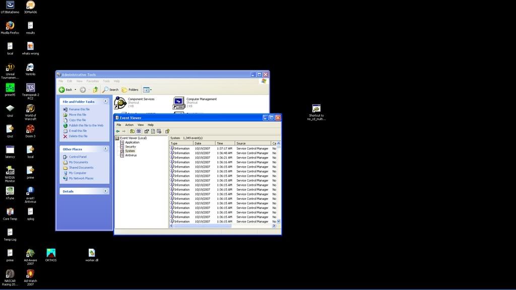

Ah man, no worries, please. You have never done anything but help me.. Anyways, here is some more stuff I found. Check this pic out, is this normal? note the time stamps. screeny

There sure is something not right there. Does the system seem slow compared to normal? What are the specific contents? Are they all the same? Do they go away if no apps are running? If you continuously hit F5 do you see more? Does it happen right after boot?
If it happens in all cases, I would quarantine the pc.
I don't think it's best to have more than one malware checker running simultaneously. I would remove one and recheck for this stream of events. You might try going to the symantec site, etc. and running their online scanners.

Only 20 processes and no applications are running. And no, its super fast atm, no stability issues.
What about the flood of messages in the system log - still happening? Do the app and antivirus logs look ok?
