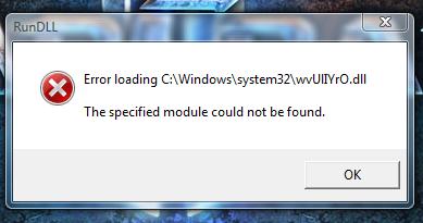

I'm not sure what I did but every time I boot into Vista 64 I get an error message that says:
Error loading C:\Windows\system32\wvUlIYr0.dll The specified module could not be found
I tried googling that dll but don't find it. Part of the problem is I don't know if the 0 is a number or a letter although I tried it both ways with no luck.
I even tried making a blank file with that name and throwing it in the system32 folder. Any idea how I can fix this? Everything seems to run fine without it.
Here's the error message LINK
Thanks in advance for the help.

I'd be worried about an infection of some kind. That file looks suspicious.

You were infected, and now you aren't (at least by that DLL/Virus) anymore.
Do an offline (BartPE, etc.) virus scan, and remove anything found.

Originally posted by: Rubycon
Yep!
Download MalwareBytes' Anti Malware here:
http://www.malwarebytes.org/mbam.php
Run this and see what you find/remove.
Well, it looks like that did the trick. There were three infections found. I deleted them and when I rebooted no more error message.
Thanks for the help!
