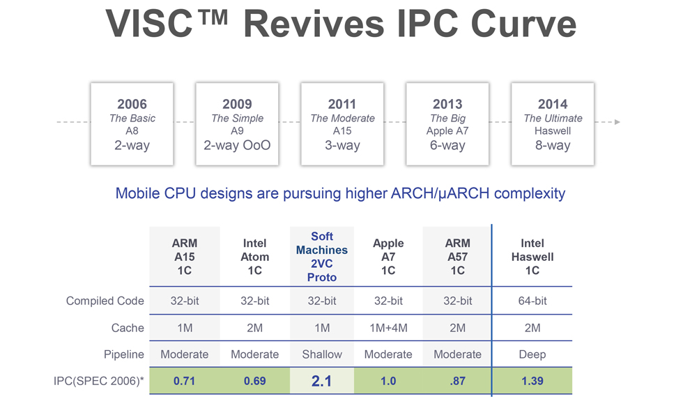

The most useful part of that slide, IMO, is the comparison of the Apple Cyclone, ARM A15, ARM A57, and Haswell.
One thing about that graph is they used the GCC for Intel's CPUs as well. ICC would help the performance significantly.
Nothingness
Jul 3, 2013
3,023
1,952
Using the same compiler is a good way to compare things on a level playing field. It's very well known that icc is heavily tuned for SPEC, which makes comparison quite biased.
For that last ten years, every time I tried icc on the various codes I worked on, it brought no speedup over gcc, not all code can benefit from icc (note it seems to shine at vectorizing, my code simply doesn't benefit from that as a lot of code).
