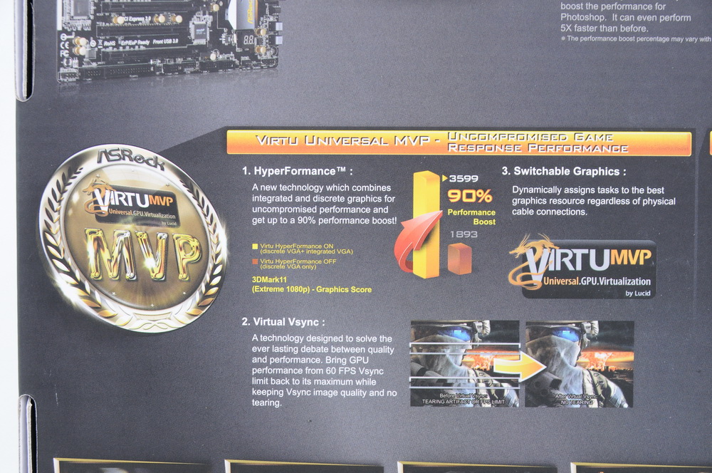

So the z77 panther point motherboards that go with ivy bridge 3770k's claim to have this amazing new graphics technology.
There's actually 2 cool points. It can use the onboard integrated HD4000 Ivy graphics to boost your discreet graphics card power (vendor agnostic).
But the real kicker is this: "Virtual V-sync". They let you unlock the refresh rate lock of v-sync (so you arent locked at 60,70,85, or 120fps or whatever your panels refresh is) but you get to keep the benefits of v-sync by having a smooth image with NO TEARING. Sounds too good to be true, and its from your old friend Lucid. hehe.
Any thoughts on this "Virtual vsync"? Would love to have zero tearing at 100 fps on my 60hz display.

that all being said I have very little faith in this technology to do anything tangibly good or better than what experienced users can already do on their own. Their HyperPerformance technology is a joke as it implies you're going to be pairing a discrete GPU no more powerful than Ivy's iGPU.
and as a rather competitive gamer, I wouldn't even trust the switchable graphics to not add some degree of input lag, although that is the one feature that has the most potential as it should mean you could power down your very beefy dedicated GPUs...granted, that's not much of a issue these days as even the beefiest modern GPUs are now scaling down to draw next to nothing when they're not being pushed.

If they’re still synching to the refresh rate with an uncapped framerate, they must be dropping the excess frames.
Interestingly enough triple buffering will also drop frames in the fringe cases where the framerate gets very low, so this is like the opposite.

With virtual -v sync. you get higher than 60 FPS without tearing. Online gaming this will be big.
Big for online gaming? I don’t think so.
Than switch on the Lucid performance mode and from a NV 560 ti you get AMD 7970 performance . Thats right you read that right . This is the biggest thing to come around in years.
Not really. They promised automatic scaling and that application specific optimizations wouldn’t be needed, but that wasn’t the case.
All Hydra does is increases your ability to mix-and-match boards for multi-GPU, which I guess could be useful to some. But it’s hardly earth-shattering.
