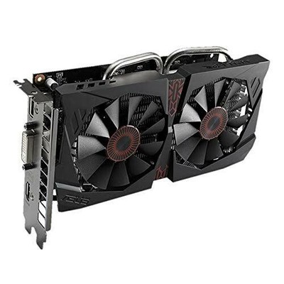

To be honest, I'd recommend grabbing something like a 750ti 2GB for that kind of box. I've used them in systems of that age and even older (x58/i7-920 and C2Q-9550/x38) for example).
+You can find them secondhand very cheap.
+They use little power and won't overwhelm your PSU
+They're not bulky and will easily fit your case
+It's a good match for your CPU performance, you won't leave performance on the table at all
+It's a monumental upgrade over your old 220
+It will give you great video output options (DVI + Displayport + HDMI) and support 4k/30 and 4k/24 for HD accelerated video playback.

Thank you very much. Can I find anything new, such as EVGA? Looking for 2.0x16 - single socket- 64 bit. I believe the card you are speaking is 128 bit.
Hi! The 128-bit listed for the 750ti refers to the onboard memory bus width, it is still a standard PCIe x16 3.0/2.0/1.1 compatible card.
I'm sure there is some new old stock 750ti out there. I'll take a look.

Forget the bits, they don't make PCIe slots different for different bits :) It refers ONLY to the interface on the card itself between the GPU and onboard VRAM. You can use 64, 128, 192, 256, 384, 512 bit cards all on any PCIe x16 slot.
In the video you posted, you'll have no trouble with a wider card, just not a very long one. It will be larger by about an inch further inside the case, but will have plenty of clearance going by your video there. You will have to remove the slat cover in the next slot over. Don't be intimidated, it's easy.

The performance gap is immense as well.
A GT 710 is 122Gflops (.12 TF)
A GTX 750ti is 1400Gflops (1.4TF)
More than 13x faster.
For reference from the old one
A GT 220 is 72Gflops
*-64-bit FP
Reactions: synoptic12

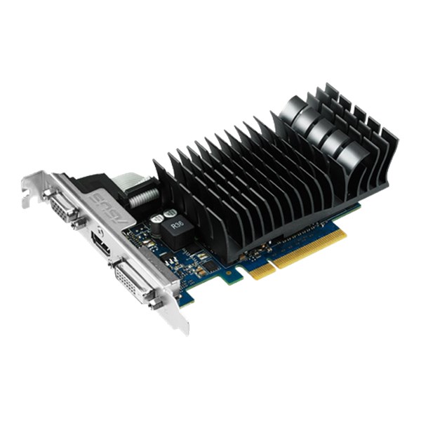

Yes, it will work. Nvidia Maxwell and older GPUs do not require UEFI-compliant motherboards to work.
So Nvidia 200 series, 300 series (OEM rebadge of 200 series, not a real release), 400 series, 500 series, 600 series, 700 series will all work.
710 is fine. It is less than 10% the performance of a 750ti, but if you literally do nothing with video performance demands, it will be no big deal either way.
The big thing you want to avoid is :
Newer than 700 series
And cards that require PCIe supplemental power connectors. Such as 760/770/etc
Given the choice between a $50 710 and $60-70 750ti, I'd have a hard time refusing a 750ti, you get a lot more capability for the money, but either will solve your problem and even the 710 is a minor upgrade from the 220.
However, your MSI H57 motherboard has onboard video that will work if you simply remove the 220 if you have a VGA cable for your monitor. If you do not need performance, it is more than capable of regular windows operation.
None of the cards mentioned between 200-700 series require UEFI, and all will work for you.

I've used this exact one many times because it works great on older computers with or without UEFI support:
No fan to possibly go bad either.
* Thanks very much. I was looking at that card but was hesitant on having no fan and being MSI. I'm unaware of the warranty or how well the drivers are. EVGA provides a three (3) year warranty; unknown as to MSI's Warranty and Support.
* I'm somewhat familiar with heat sinks and have concerns of the heat dissipating inside the case. This is why I believe a fan is more useful (IMO).

The card stays cool enough with a heatsink that a fan isn't needed (it's also another thing that will die). MSI is a great brand and a top tier company. The drivers you can download straight from Nvidia and get the latest. You don't need to use theirs. I believe the card also comes with a 3yr. warranty.

The 700 series is what you might call 'UEFI Aware/Compatible', but not UEFI Exclusive. I've used 700 series cards on extremely old boards (circa 2005/2006) without issue, because they work on legacy BIOS without issue.
The 710 is an ok option for a passively cooled no-fan card due to its combination of very tiny die size, low power requirements, and newer process technology.
The GT 220 used 65nm process tech. This means each 'wire' (not really a wire, but each pathway on the circuit of the actual die) was 65nm in width. The wider the circuit, generally the more power required to operate, and the more heat generated.
The GT 710 used 28nm process tech. Now the 710 is clocked a bit higher, and has a higher transistor count, but in total it's a cooler running card.
You will be ok with any 200 through 700 series option you can find, as long as it doesn't require 6/8 pin PCIe power, or is too long to physically fit. I've used your exact HP case dozens, perhaps 100+ times in repair/upgrade, or even new mATX builds using spare parts from non HP units ('mutt' PCs, which I put together from donated/recycled materials for a local food bank/charity/resale outfit).
