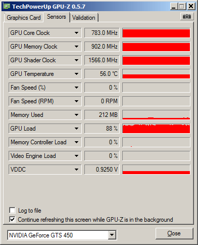

GTS 450 @ stock
2D: 0.96v
3D: 1.06v
-TO-
2D: 0.86v
3D: 0.925v
-RESULTS-
~3oW power saving and 15c temp drop. Not bad at all.
Could have lowered more but I settled for this. A few days at number-crunching proved its stability.

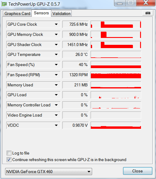

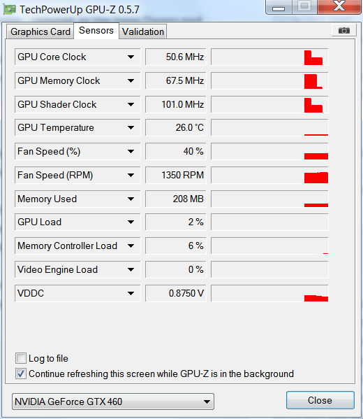

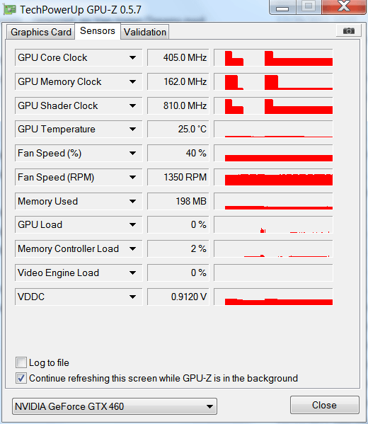

I'm not sure how you are figuring that savings.
This is the stock behavior of my gtx 460's.
They have 3 voltage states.
With a single monitor. You lose the 50mhz state with dual monitors.
50 mhz
405
725
50 mhz
405
725
I used a kill-o-watt device for measuring. Not the precisest method but good enough to spot the difference.
If you're curious as to what happened to my middle p-state setting?
That's easy... I merged it. No point to have it, all my mkvs can do fine with the lowest p-state performance for maximum power savings and when I need to use GPU, it goes straight to "Performance" mode. Like I said, during load I shaved off ~30w and 15 temp drop. (In BF3, total system consumption doesn't exceed the 170w mark). And my fan setting set to 0 RPMs until the gpu temp reaches 50C (load activities mostly). Efficient, dead-silent and cost-effective (I got it on the cheap too :D).
P.S. The stock fan had to go unfortunately, it wasn't anywhere near as quiet as I wanted it to be. Used rubber pads everywhere I could.
EDIT:
Desktop... movies... the card turned out to be as efficient as my old Geforce 6200. Not bad at all.
