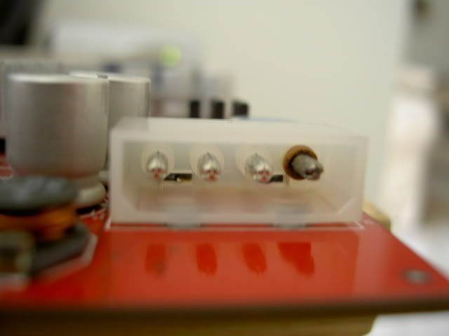

Video card stopped working (have a new one on the way) but does this look fried?
Too much power running to the card? what could of caused this?
Thanks.

Thats the +5v prong, looks like you should check your PSU, there was possibly a surge from it. Get ahold of a multimeter and test the +5v line of your PSU, it whould not be lower than 4.5v and not higher than 5.5v .

That was caused by poor contact from the plug to the card. Clean it off and fix the loose connection and it should work fine provided the card didnt suffer from the bad contact.

Thanks did what you said and cleaned off the connectors with a q-tip and some isopropyl alcohol and it works great.
Thanks.
