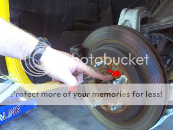

is this what the centering rings are for? sample pic of another vehicle You'll notice there's a clip there that they say OEM wheels will account for but aftermarkets (which mine are) probably doesn't.
*UPDATE* I spoke with the company that sells the rims - they say the vehicle won't even accept hub centric rings and their wheels don't require them. We had a good 5-10 min conversation and he was pretty knowledgeable so it wasn't like he was trying to squirm out of responsibility. He couldn't do anything for me after a year of use anyway. He thinks the guys never actually did the road-force, which usually accounts for up to 120mph. All I saw was a spinning wheel and unsure if anything was pressed against it from my angle. He thinks it's the actual Toyo tires that are bad because when a store gets a new rim they are supposed to spin the rim... 2 places have confirmed the rims are not out-of-round. At least I get lifetime roadforce from that shop now so I'm probably going to go back and have them do it over - taking the tires off to ensure every step. I can't really do anything else other than buy new tires to try and I'm definitely not doing that.
