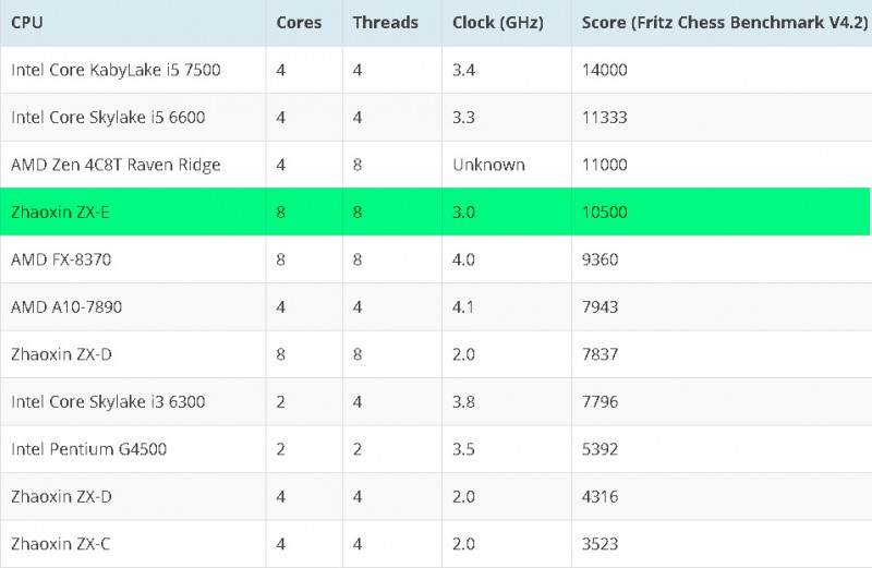

Well except Geekbench, KX 6000 CPU performanse expectations or estimates it is old news.
Fritz Chess Benchmark is one and half year old information.Manufacturing process for KX-6000/16nm, this is also old news or announced almost a year ago.
