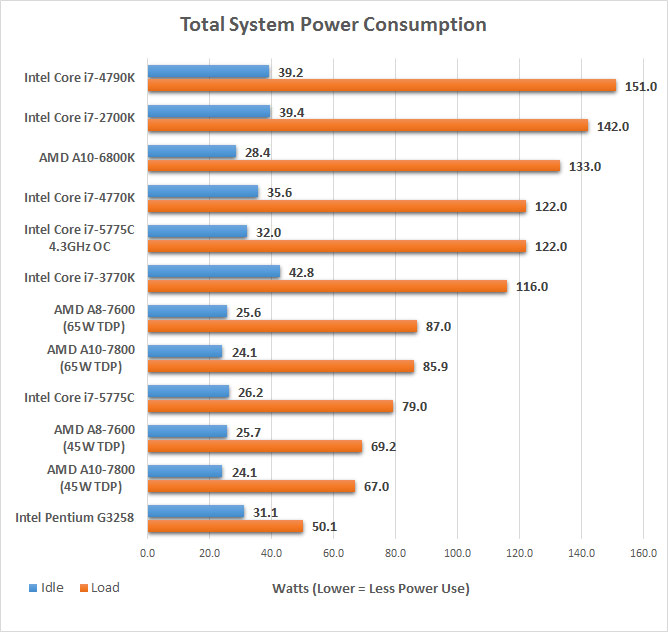

The adapter I am using is a regulated 12V/12A (144W) adapter, but I don't expect power usage to go that high, obviously.
It has a 20+4 pin layout and is fully ATX compatible in that regard.
The case that I will end up using is somewhat irrelevant at this stage, I just want to focus on the power envelope. From most reviews, it would seem that something like the Broadwell+Iris Pro would work perfectly fine under load. Either the 5775c or 5675c. Even the AMD 7800...
Also,
http://www.tomshardware.com/reviews/intel-core-i7-5775c-i5-5675c-broadwell,4169-4.html
Lots to consider, I think.

I think you are out of your mind. even at idle a pc like that would be using 60-70 watts or more and under full load could easily go over 100 watts.
Not if you don't overclock them. The CPUs idle at the same wattages as the rest of the lineup, and the newest ones are only 65-84w. If the rest of your system is only eating ~20w or less you're fine.
toyota
Apr 15, 2001
12,957
no you are flat out wrong. a modern i7 system would go over 100 watts under full load. if just playing a game on my IGP I hit 140 watts at the wall even at stock speeds.
I don't think that they're so wrong. My SKL G4400 + H110 Asus mobo, under full CPU load, with 24" LCD monitor, draws 59-61W.
140w from the wall is probably only ~115-120w (at most) of actual component power draw. PSU inefficiency is a thing. An 80% efficient 120w PSU will draw 150w to deliver that 120w. (Varies depending on the PSU, obvs.)
Here's a review of the 4770 that put power use at under 100w under load with a 150w PicoPSU.
"flat out wrong."
Try running the Intel Power Gadget - it'll tell you how much power your CPU is using (vs. the rest of your components.) I've run it on my 3770 machine at work, so I know that the CPU itself idles at <10w and hits ~70w at full tilt, so I'd be curious where the rest of your juice is going.
"flat out wrong."
Is that the same i7 rig in your sig? The one that's overlocked, has a GPU and Sound card sitting idle using X watts each, 1.6v RAM, and a 750w power supply that's way outside its efficiency sweet spot? How many hard drives and LEDs you got in that thing?
you need to brush up on your reading comprehension. I said when under full gaming load on the IGP and I said at STOCK speeds. and I am not an idiot so of course I know 140 watts at the wall is less actual watts but the POINT was that it goes WELL over 100 actual watts.
Look man, you're completely wrong. A modern i7 (Broadwell/Skylake), non-OC, no dGPU, one SSD, and two sticks of RAM can barely hit 100W under load. I already posted benchmarks above to prove it. Just drop it.
