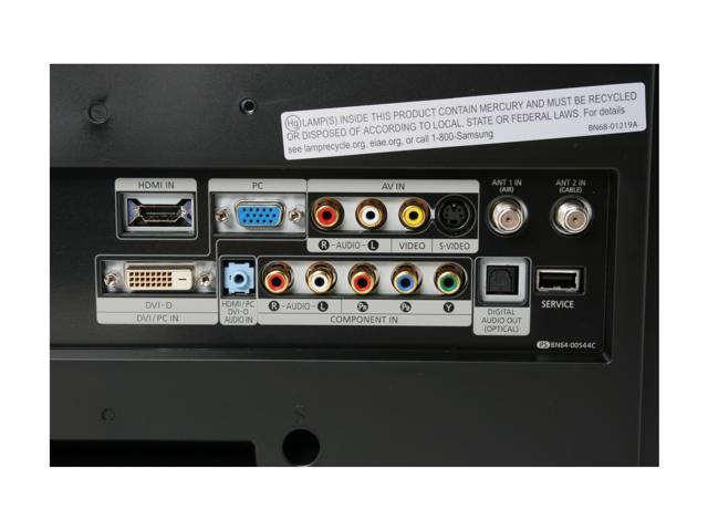

I have this TV.
click
Pic of inputs on TV
pic
How do I Hook these two items up? So I get Audio out of my pc speakers?
Can I somehow hook the Digital Audio Out (optical) to my speaker? or even my PC sound card?

Where are you plugging it into the TV?
I see the TV has a digital optical output... is there another audio output?
I see several types of inputs on the TV, but you need to connect to an output.

I thought we were talking about how to connect it to the TV

Now... Those speakers are digital, I do NOT know if you can just put a regular S/PDIF connection onto them.

The adapter is your best bet. Just run the optical cable from your TV's optical out to the adapter, and then a coax digital cable from the adapter to the sub and you'll be good. As far as the optical cables at monoprice, I have 3 of the normal ones, and one of the premium ones... they all work perfectly. The 3 normal ones (6ft each) are all hooked up to one of their optical switches, which is in turn run to my logitech z5500 system. The one premium one connects my parents sammy 4065F to their receiver (12 or 15ft cable I can't remember). I will say, if you are worried about any sort of abrasions or whatnot (IE: from pulling cables around), go with the "premium one" as the jacket they put on it is top notch. If you just need a short run somewhere, the normal cable definitely will do the job for you. In the end, they both are cheaper than anything you would buy at a big box store.
Edit: if you just want to cop out and do it the easy way: http://www.buy.com/prod/pionee...loc/111/204509050.html
Those have both coax and digital optical in. They also would give you a AM/FM tuner and true 5.1 channel sound. Use google checkout ($10 off) + free shipping and you get a decent pair of speakers for under $100.
