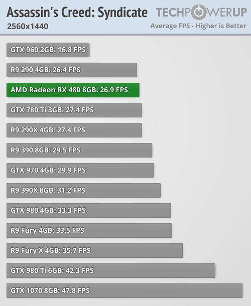

Ok last game Assassins creed syndicate
2560x1440 all max +FXAA
GTX1060 simulated
Avg: 31.5 - Min: 29 - Max: 34
Stock GTX1070
Avg: 45.034 - Min: 41 - Max: 48
GTX1070 2100/9400
Avg: 54.737 - Min: 50 - Max: 58
GTX1070 is 42% faster.btw pretty similar results with techpower UP using GTX1070 and 980.GTX1070 is there 43% faster than GTX980.
