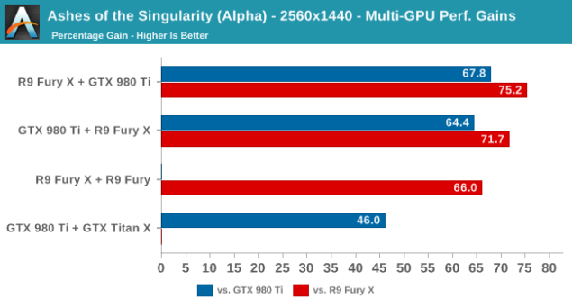

Hmm, you could always use any two or more gpus from any vendor in 2D mode. You just can't use them together in 3D mode, ie. in a game like for ex. use the Nv card for physx because it's disabled by Nv.
DX12 brings with it both multi gpu and multi adapter. Both allow mixing of different gpu vendors and gpu + igpu. It's goood stuff. You can see it in action with reviews on Ashes.

Yea, it should work. I had a 290x and a gtx 750 for Cuda development. One monitor attached to each. If I switched the main display games would render on the gtx 750.

We've always been able to do that. If either side prevented that, it would probably be illegal in some way. As mentioned, you just switch to the monitor plug, etc.
