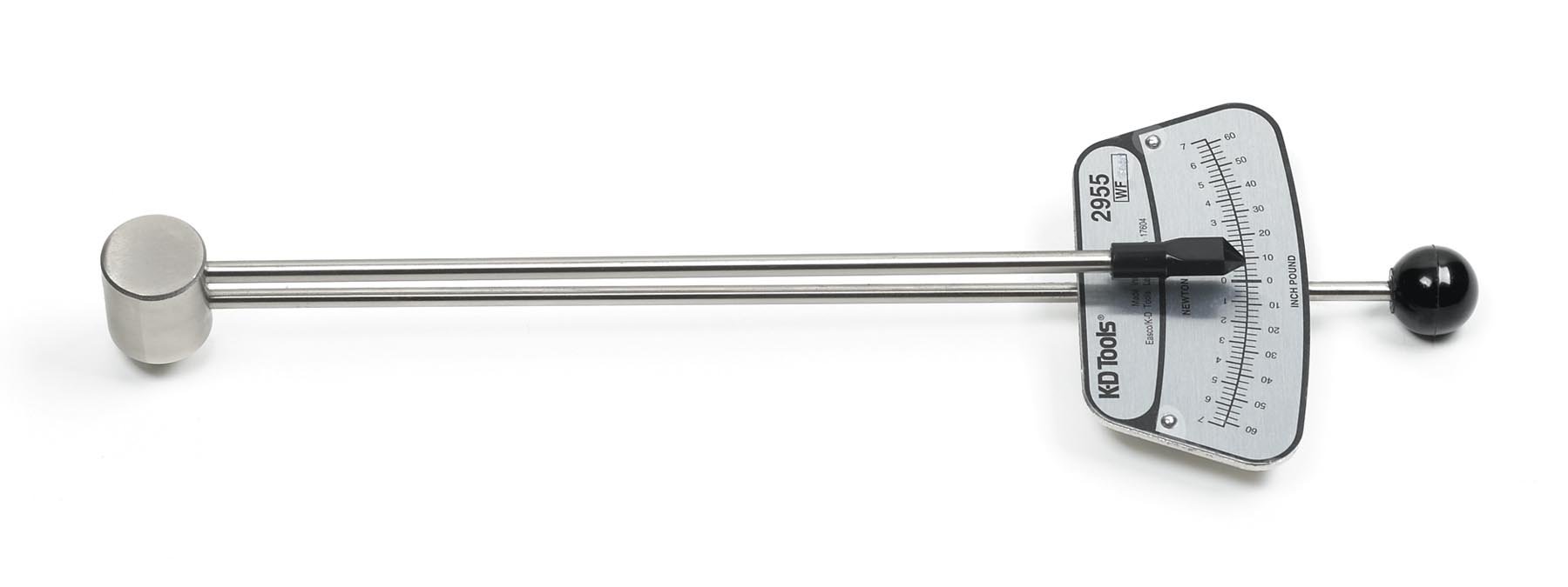

Using a Mirror To Read Beam TQ Wrench

How do I use a mirror with this type of wrench? Do I lay it right behind the numbers?

To remove the Parallax Effect. I need it to be as accurate as possible. Its my only choice.
If you need as accurate as possible, I don't think that's the right type of torque wrench to use. Seems like it would be difficult to read it accurately while trying to apply a decent amount of force to it.

it's accurate because it's simple, although that particular model has a large gap between the needle and gauge.

It could be more accurate in theory, but a good micrometer-style TQ wrench would probably be more accurate in practice, just because you don't need to worry about parallax or...mirrors.

Thanks Guys but this is my ONLY option. If I could I would use a different tool.
Do I put the Mirror Perpendicular to the Number I am going to?

37 inch-lb I need to tq in a somewhat accurate fashion
a 20-250 inch lb china freight click type will be off by a huge margin.
Ill stick to the beam type that's from 0-60

Epoxy a small piece of bent paperclip to it as a pointer that's right on the scale?

When was it last calibrated? without that information, I can't tell you how to best read it.
Assuming it's calibrated correctly, the dangler's suggestion of closing 1 eye should be plenty god. Your marks look plenty far apart that angle doesn't seem to be a big deal to figure out which mark is the closest.
Only for lack of imagination, or artificially constrained rules.
Winner winner, chicken dinner. This will eliminate any parallax issues. Or just bend the indicator beam down, if you're feeling ballsy.

For everyone's curiosity
I have a group project which I made this fixture above. We had Two of these with an aluminum "gasket" in between and we have to put it on a tensile test machine and see if our calculated preload was correct. Our axial load was not too high (2500 lbs)so this was the only way to cheaply tighten our bolts semi accuretly.
We tested it and we were about 10% off which was good.

I am not sure what you are talking about. Are you saying 37 inch lbs isnt high enough to get the fastener to work properly? The Max torque for Grade 8 1/4-20 bolts is ~12ft/lb.
We are just preload failing. Our Specified Tensile Axial load is 2500 lbs. We need to apply a certain amount of torque to the bolts so that when using an extensometer the preload "fails" as shown on this pic below, we need to exceed the preload so at 2505 lbs
Basically using Toruqe = Force * K * D
K is the Nut Factor
Diameter

Given that you were within 10% of your calculations, that means you are doing right and I am just not understanding your experiment. So getting back to your original question, most torque wrenches are not going to be any better than 10% in terms of accuracy. So grab a cheap HF and calibrate it yourself using weights. That is your best option.

Frankly, getting withing 10% is doing really well for a torque wrench. Friction and thread inconsistencies will tend to make things much, much worse than that.
I ran your numbers and they seem close enough.
If you want to go super-pro-legit, use an ultrasonic device to measure bolt stretch :awe:
