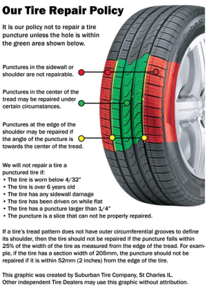

It's been my understanding that radial's shouldn't ever be plugged, has that changed?
I've never heard that. Don't bias ply always use tubes? I /think/ it might be unlawful for a professional to plug a tire in MD. I was told that by someone a long time ago, but without looking it up, I can't confirm. I've plugged a lot of tires over the years, and aside from *ridiculous circumstances, I've never had a failure.
*Years ago, I hit something on the road, and it looked like a piece of rebar went through the tire. I put 6 plugs in it, and was able to get it 50mi home with one stop to top up the air. Most recently, I got another big hole, put three or four plugs in it, but it was still leaking fast. Got me 15mi to the shop to get the tire swapped out.
Back in the day I used screws in my tractor tires, and lags a couple of times when I drove half inch rebar into them. They were water filled so minor leaks weren't a problem.
Where I am (Ontario, Canada) I've never heard of a ban on plugs. Many small punctures I've had over the years have been repaired that way by my nearest garage, and they have never been a problem. In fact for most cases the have removed the tire from the rim to remove the item (nail, etc), clean the tire inside and out, install the plug with glue and trim it, then often add a patch inside to ensure no leakage. It's been a long time since it have had bias-ply, but i am sure the same techniques were used on those tires, too.
Plugs can work on parts of the tire...but, (obviously) not the sidewall, and should be avoided for the shoulder of the tread.
However, if you're out in the middle of nowhere, a plug kit MIGHT get you into civilization where you can get the tire fixed properly...or replaced.
