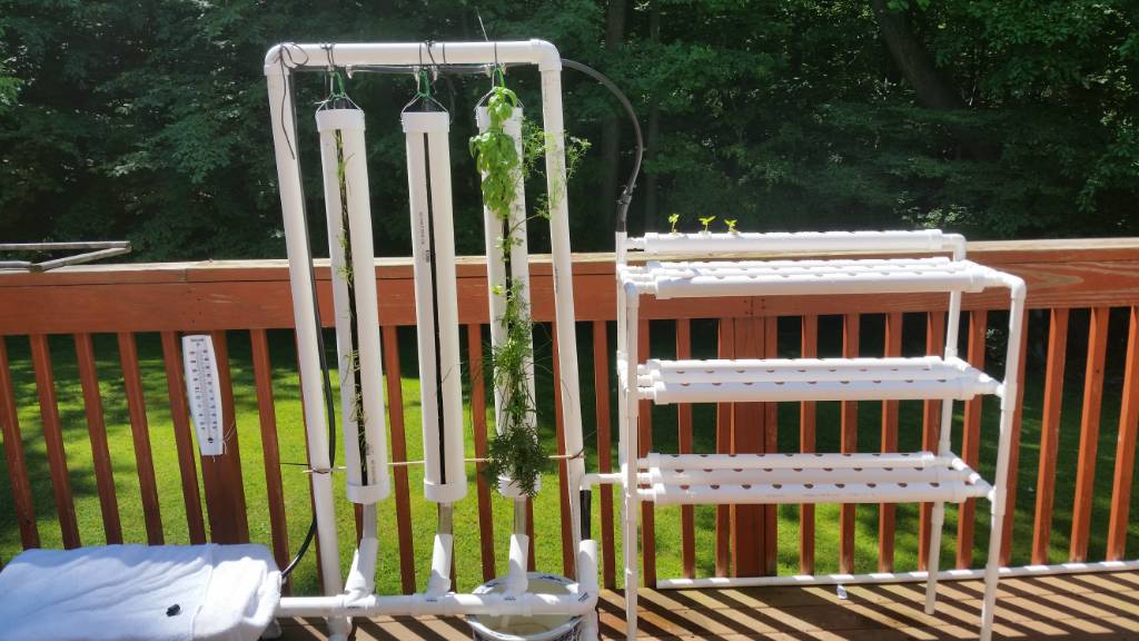

I bought a hydroponics kit to mess around with and all the PVC pipes are friction fit into place. No threads any were. The kit came with a roll of Teflon tape.
Uhhh... My impression was that Teflon tape in only for metal threads. It should not be used on PVC threads, but I'm not sure about friction-fit PVC.
There's hardly any water pressure anywhere in the system (water just flows from section to section via gravity). Should I use the Teflon tape for these friction fittings?

Put it in your toolbox for later use. If it doesn't leak, you can't ask for more than that.
BoomerD
Feb 26, 2006
66,420
14,820
I've always glued that kind of PVC.
yeah, "friction fit" aka slip fittings, are meant to be glued together. I almost always use purple primer before gluing, but for low pressure, it's not always necessary. (but still recommended for a good bond)

Are they press fit? There are shark bite type fittings for PVC.
You can use teflon tape with plastic threads if you want, you usually don't need to though because it's not hard to tighten without it.

In the world of pool pump/filter plumbing, it's common to use Teflon tape on threaded pvc connections.
Of course unions do not need any Teflon tape.

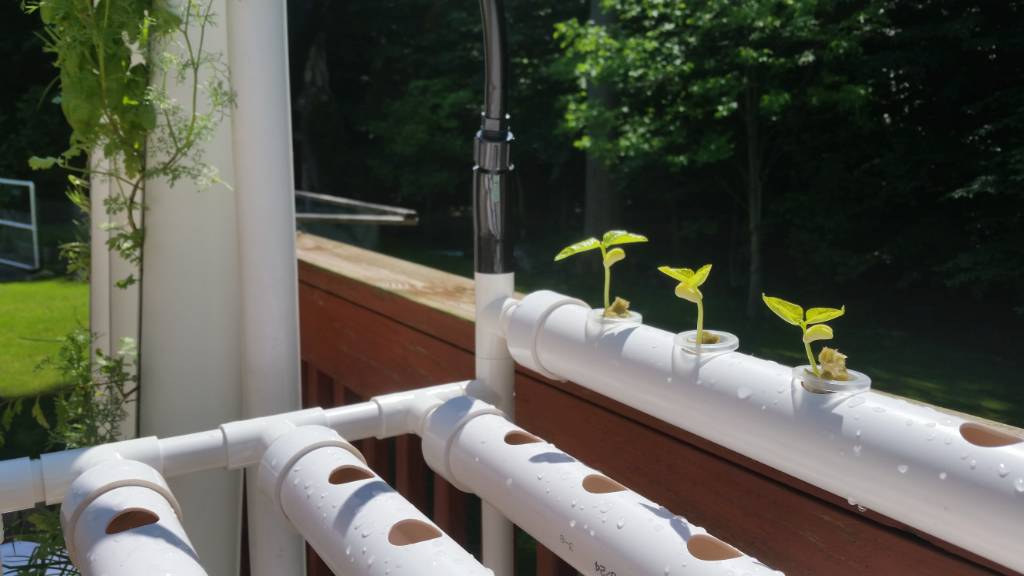

Just experimenting with gardening. The thing on the right is what came with Teflon tape. So far there's been zero leakage that I can tell, even though water pools in each of the horizontal pipes.

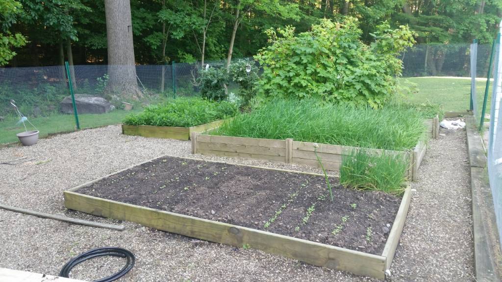

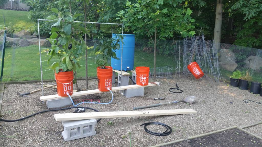

Also making a self-watering bucket system for tall/thirsty plants with a trellis made from conduit and rebar. Peppers, eggplant, tomatoes, and other random stuff. If you do this don't use a toilet float valve unless you've got this hooked up to the water mains - gravity feed doesn't provide enough pressure to overcome the internal resistance of a toilet float valve.
The garden has Chinese veggies and a raspberry bush.
I also fucked up my two tomato plants in the last picture (I think) by planting them too close together (barely 2 feet apart, and they're indeterminates). Gonna dig them up and place them in buckets probably.
