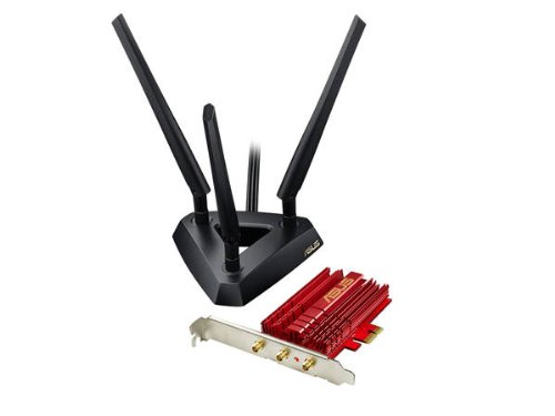

Unless I am missing something, USB is not carrying the 802.11 radio signal. The conversion happens within the radio controller in the box that the USB cable leads to. The USB cable length is irrelevant. This appears to be the best of both worlds:
Now since there is an antenna cable carrying signal up to the tri-tenna then there is signal loss in that cable but it is probably offset by the ability to position the antenna apparatus more effectively.
