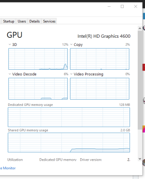

OP can monitor the Video Decode and Video Processing graphs in Task Manager during the video editing to see if the GPU is being used.

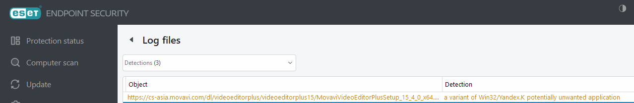

The one on the official site is being flagged as suspicious:
The latest version executable seems to be clean but it's very small so it's downloading something during setup. Not really interested in finding out.

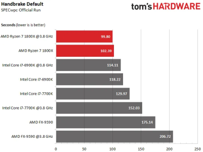

Just to show a quick example. Handbrake is a program used to encode videos. A 2017 Ryzen 1800X is twice as fast as an FX 9590, which is an overclocked version of your CPU.
article
Something newer like a Ryzen 7 7700X is over twice as an 1800X.
I would upgrade to a new CPU with 32GB of RAM and a compatible motherboard. You can always upgrade the GPU and SSD later if needed, but I think a CPU upgrade will solve most of your issues.

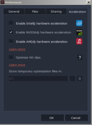

From a quick google, I'm not sure if your application even supports hardware acceleration on the 1060 with newer drivers. https://movavi.freshdesk.com/en/sup...-i-cannot-enable-nvidia-hardware-acceleration Movavi Video Converter 15 (different program, but same company and same year) uses the older NVCUVENC which was dropped in newer Nvidia drivers. Can you do a quick test editing a short video with the Nvidia hardware acceleration turned on, and then again with it turned off? I'm curious how long each one takes.
Reactions: Rigg
videobruce
Nov 27, 2001
1,082
13

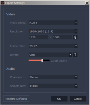

I took a decent quality, short video (1080p x264) 79MB in size
With acceleration turned on it took just over 1 minute, the size was 193MB
With it turned off, it took 2 min 20 sec the size was 184MB
That was with no editing, color tweaks, no enhancement, and default settings as to quality (there is a slider to vary the level. The 'beef' I have with that is, there are no reference numbers, you have to guess where the default setting is and just how far to vary it.
