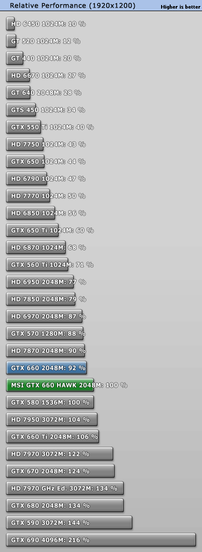

http://www.techpowerup.com/reviews/MSI/GTX_660_HAWK/28.html
Techpowerup really needs to update their drivers,these results are dangerously tainted,12.8 cat drivers LOL.
12.11 basically would have 360 flipped those results,Op should be looking at like a 7850 and i know if a 6770 fit in his case,the msi twin frozr3 at 7.73'' would and be smaller then the majority of 6770s.
