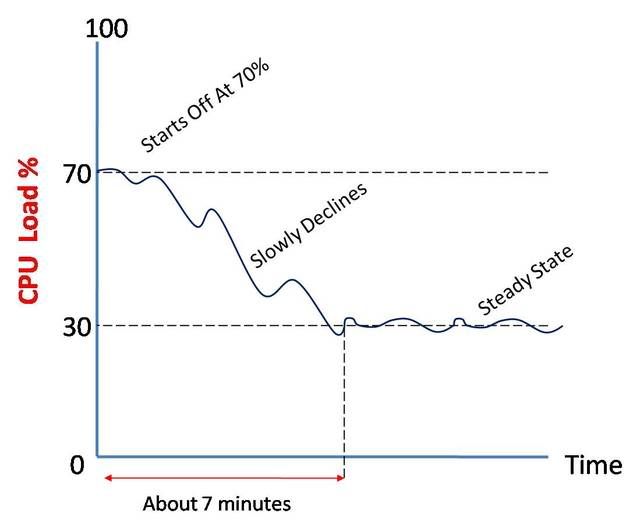

Perhaps fluctuating is a little misleading. See attached.
http://i239.photobucket.com/al...ite_Me_CR/NeroCPUy.jpg
Remember, I deactivated the power saving options.
CPU speed remained constant as CPU load changed.
