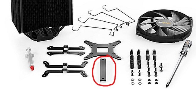

Iam on 5800X3D and be quit pure rock (not pure rock 2) in fractal design define R5. My temps were quite acceptable (used it really for a short time with few games) before I launched Battlefield 5 and started hitting 90c. I didnt do undervolt yet. I will do and If this will not help enough I will need to improve cooling.
1/ do you please think I can get considerable improvement If I just change fan on my pure rock to be some beast? Something like Noctua NF-A12x25?
2/ If I decide to update cooler completely and go Be Quiet Dark Rock 4 I can keep the MLB mount, right please? At least on pictures it looks same, except color which I dont mind. Or is it even like most/all coolers use same MLB mount for AM4 socket?
If you dont get what I mean please see picture bellow, I beleive I should be able to just take part higlighted in red bellow and instal heatsink on current pure rock MLB mount.
