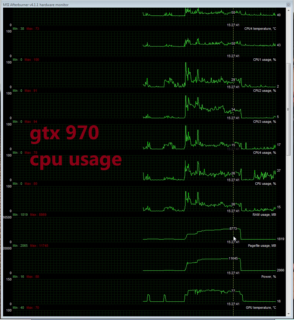

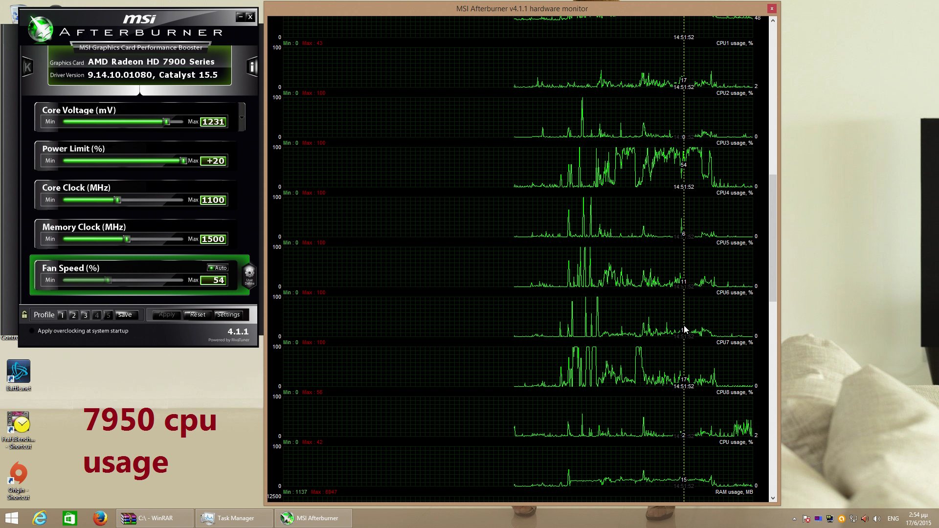

ps As a side note, what I found interesting, is how different the two cards work the cpu.
These are the cpu usages during the run, also shown in the above video links.
It seems that on the Nvidia card, there is much better threading. It is curious considering that the 7950 system is running on Win 8.1 while the GTX 970 runs on the older Win 7.
I'd request Radeon owners with faster cards, to look into this and report if they see any cpu limits in this, or different cpu load.
I went back to some other UE4 testing I did on my 7950 and saw the same cpu behavior. Maybe we should alert AMD about this?

devilsfan, really impressed by the 580//3GB. Similar performance as the 7950, coupled with the big delta compared with th 970, maybe shows that AMD needs to take a look at the Tahiti optimization?
vodka, great result on the 290. Twice as fast as the 7950 and quite interesting cpu usage.
Is it possible that the driver is better threaded in Hawaii and newer chips? I mean is this possible or am I having a localized problem?
Anyone with bot Hawaii and Tahiti can have a look on the same system?
