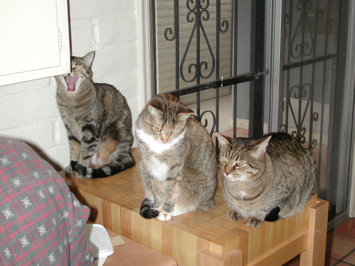

I use a food grade polyurethane on the maple block I made. It lasts 2-3 years between re-coatings. It dries in a couple hours with full curing within a day or so. I'll look up the brand later.
We bleach the crap out of the block (for obvious reasons) and the polyurethane holds up well.

Nice looking block you got there.
Cookin' up cat fillets, eh? :p
Would love to get the brand of coating you used- thanks.

holy f^cking disgusting.... glad I will never eat at your house. cats are bad enough outside, but inside??? they are a small step ahead of mice in their nastiness

I'm sure he's glad you're not eating over, too.
