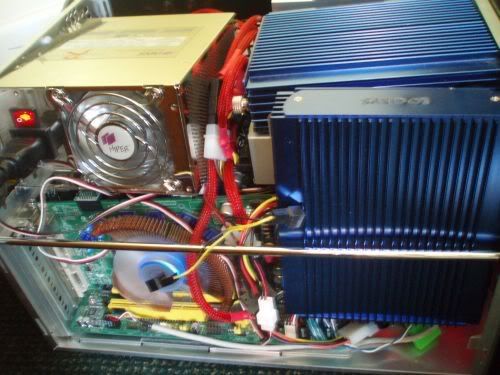

I have some experience making a lot of stuff fit into a Microfly matx case. Last month i had 2 7900gt's in SLI, a evga nf44 SLI mobo, amd x2 4200 w/ golden orb, 2 raptors in raid 0 and 1 storage hard drive, a cd drive, a floppy drive, a 500 watt psu, 2 gigs ram, 1 120mm fan, 1 hard drive cooling fan, and a 80mm intake fan. I'm not sure how long the gtx's are, but I'm sure you can fit one in there. here's a pic of it, and this psu was a temporary, didnt have my 500 watt that fit in this case yet.
http://i61.photobucket.com/albums/h56/r1c0ch3t/2.jpg
I have pretty much all those parts and the microfly FS if you're interested
