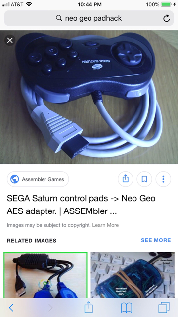

Here’s an example of a Sega Saturn pad hack for Neo Geo.
Someone literally just directly wired the buttons they needed to that cable. NG only needs Up, Down, Left, Right, Select, Start, A, B, C, D, and possibly Insert Coin (MVS), so many of those buttons aren’t used. The cables they sell at Console5 look exactly like the ones in the OP which makes me even more confident that it’s a padhack Neo Geo controller. After all: Who wants to sacrifice a real Sega Saturn controller?!
